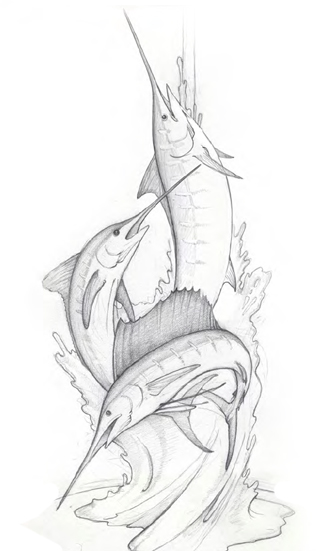

I’m currently working on a project where I need to create a water splash. I’m having some problems getting it to look like the attached sketch. Any suggestions on how to build this water? water.jpg
I have already built the marlin. I just need help on the water.

I need it to be 3D model for manufacturing purposes. That’s a great image for inspiration like you mentioned. thanks for the reply.

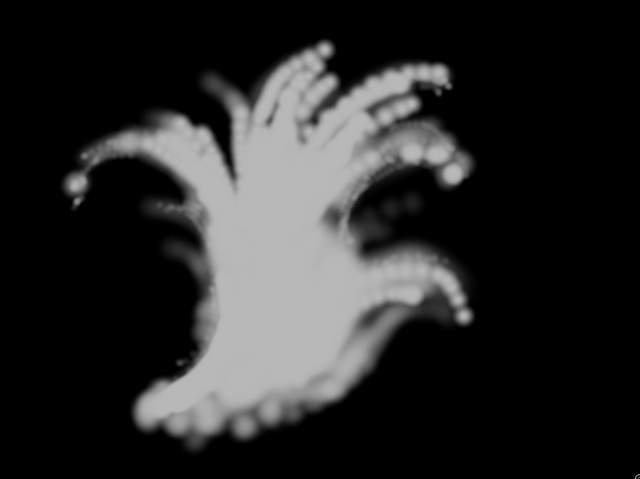

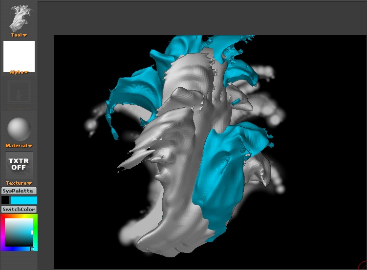

So sculpt it in 3D. Try a sphere. Or try converting an alpha to 3d, then use the deformation tools to twist it. Then do another, combine with mulit-marker and if you want make that into a polyskin. :wink:
He’s a quick example…
Just a fast image, grabbed as a texture, then made into an alpha, then made 3d under alpha 2 sided. Then deformation tools - twist, then some fast add and subtract sculpting.
You can do immense detail this way, especially if you make the alpha 3d process very detailed. :wink:

Thanks for the reply! I think that’s the way to go. I appreciate your time helping me out!!

Yeah, but you have to go cg… and wait for the download of images, then go through the many pages. Or can a direct link be supplied for just the water splashes? The technique is the same as outlined above. However the Marlin’s are sculpted from a large splash that later will be made into a physical model if I read correctly. Little splash drops won’t cut it. Oh well, Kurrie, keep us up-to-date, nuce drawing by the way. :wink: It’s been awhile since I fished for Marlin.
