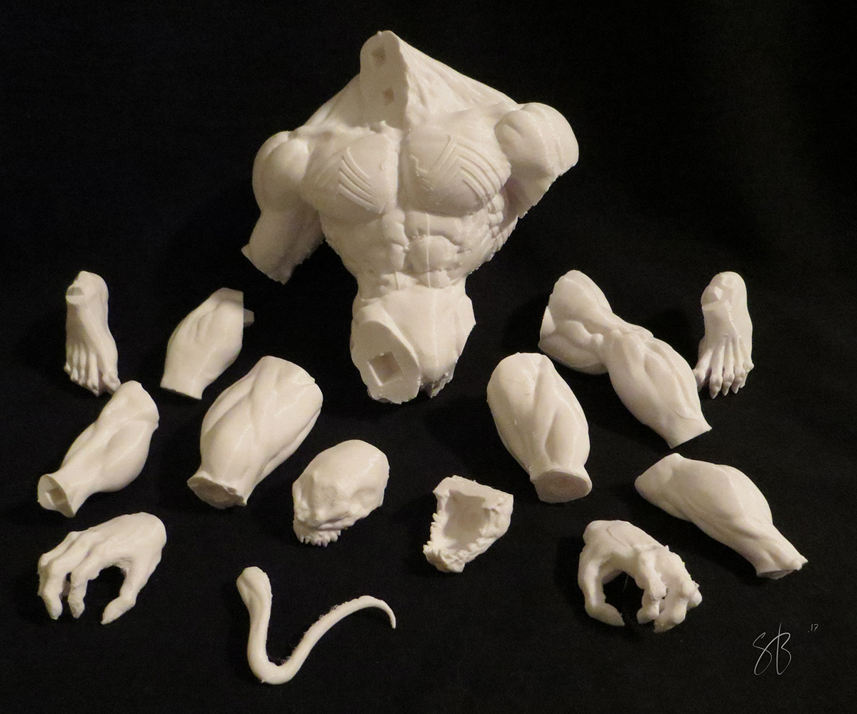

Got myself a Dremel 3D20 printer and sliced up my Venom model. Overall height will be around 8 inches once assembled. The parts were printed in PLA at 0.1mm layer height with 10 or 15% infill. I sliced and keyed in Zbrush, then used Autodesk Print Studio for setting up the prints, works great btw. Everything came out fairly well with only a few problem areas (armpit and crotch), mostly due to overhang, but the layer striations are quite minimal, and the finer details showed up. The photo doesn’t do it justice, will need to take some better pictures. It was my first print job and I definitely learned a lot. Looking forward to piecing it together and painting it up. Still need to finalize and print the base as well.
