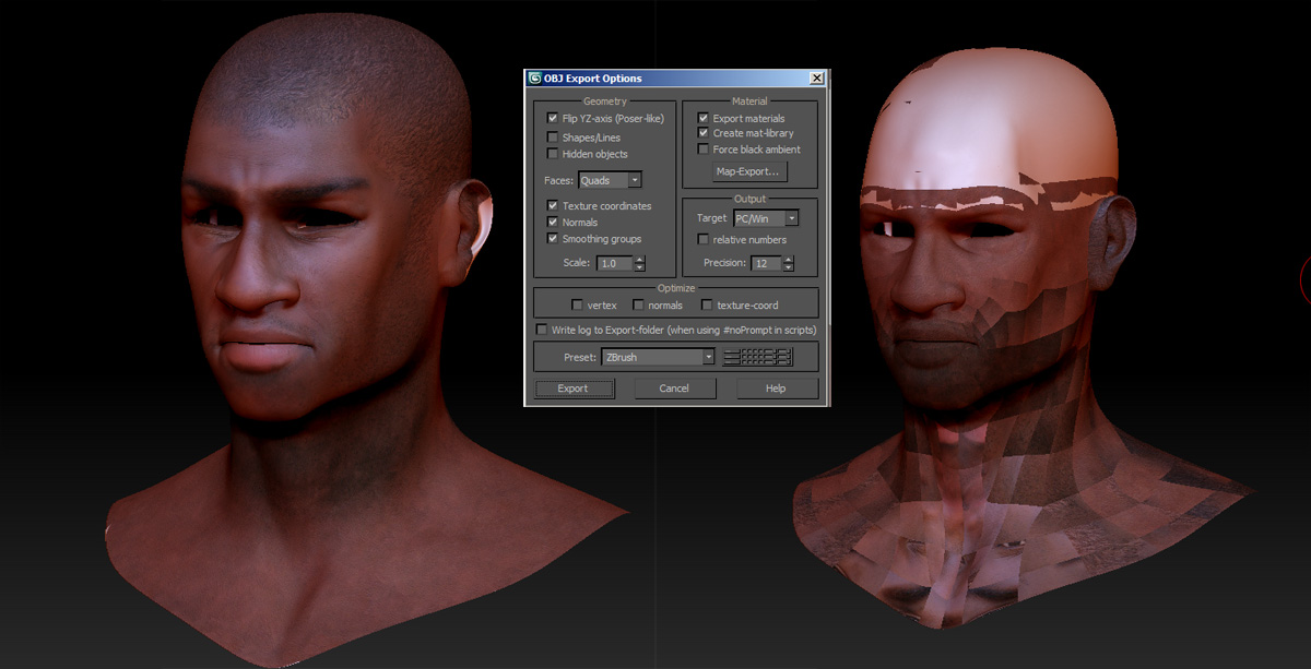

Still having the problem and I don’t see the cycle UV’s in Zbrush at all under tools. It’s basically looking like an Atlas Map. I would love to post a pic but I’m under NDA for this. :\
Got permission since this is a generic background character. You can also see my export settings.

Well, the problem is back and I doubt it is Max. The reason I say this is that when I update the model as a tool it breaks the UV pattern even to the point that cycle UV doesn’t work. I can create polymesh and apply the .obj and it works fine but then I don’t have my high res details. Guh.
The only people that have this problem are max users. Max uses a gw obj exporter while every other program uses the wavefront obj.
The problem probably come from both sides. Max exports a wonky file, and Zbrush can’t read that type of file.
Try importing your mesh into blender (or any other 3D app) and export out the mesh as a wavefront obj and see if that fixes the problem. If you have an older version of Max you can try in there as well. I think 2008 or 2009 is when autodesk changed their obj type.

I just don’t understand how in Zbrush I can import the file two separate ways and it will work one way and not the other. If I am trying to update the mesh it screws up but if I bring it in from scratch it is o.k. Plus, I can do an, “equalize surface area” and that fixes the uv’s on the mesh I’m updating?
