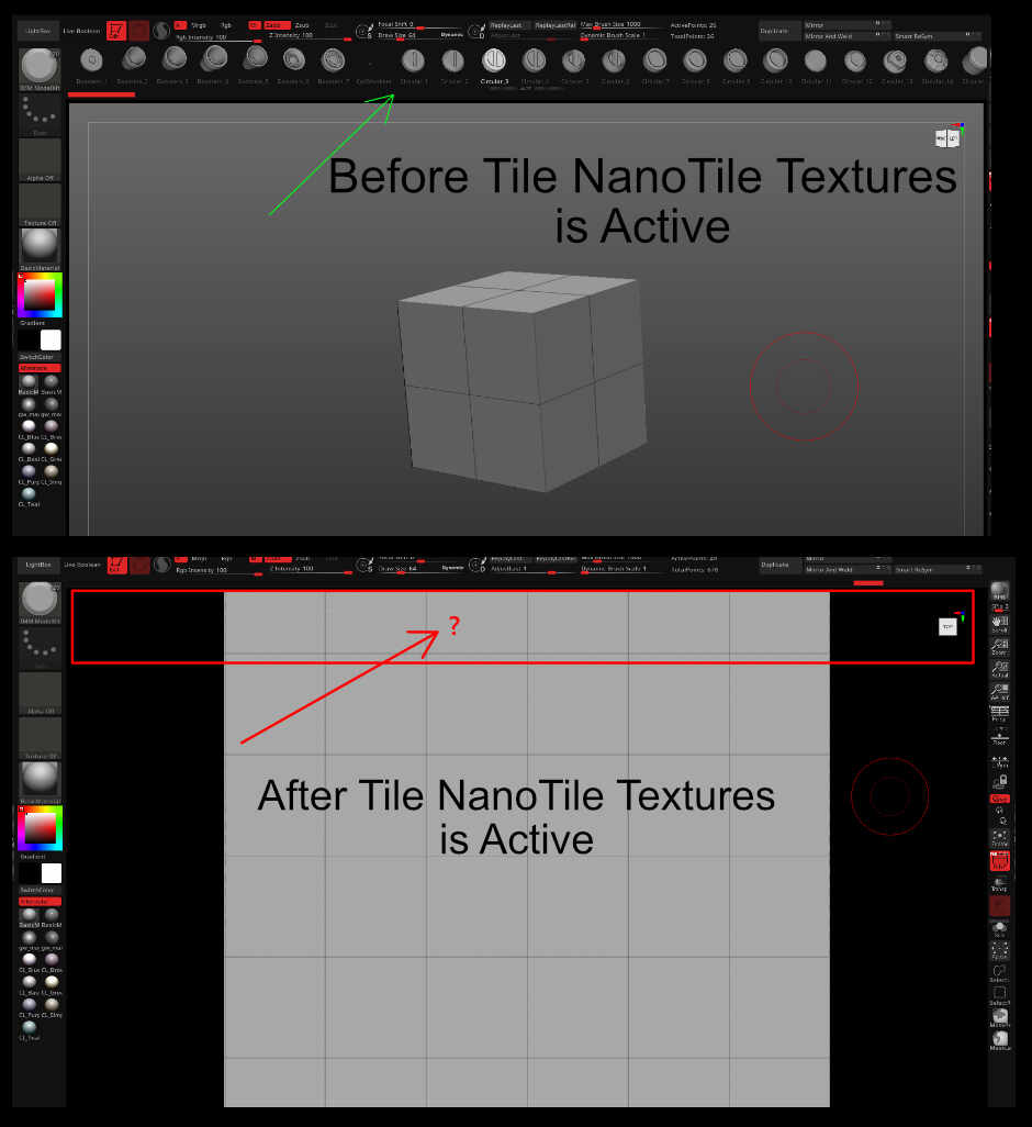

So I’ve been trying out the Nano Tile textures plugin downloaded from the plugin resources on pixologic site. It works pretty nice expect for one thing. The menu you use to select different meshes in a multi insert mesh, or chisel mesh brush disappear. I have no idea if there is a setting that turns that off and on. Would make things a bit easier to be able to select items in those menus to tile on the plane the plugin generates.
NanoTile Issue
Does anyone know if there is a setting to turn that menu on and off or if there some other weird thing causing this problem?

I don’t use that plugin so I can’t attest as to why it would be causing problems, but you can look in “Preferences > Interface > IMM Viewer” to see if “Auto Show/Hide” is still enabled or not. If it isn’t enabled, enable it and see if the IMM Viwer appears again. With an IMM brush selected, you can also just press the M key to get a palette of all the parts in that brush that you can select. Hope that helps.
Thanks @zber2
I didn’t know that there was a hide show button apparently the plugin is turning it off, but switching it back on and it works.
