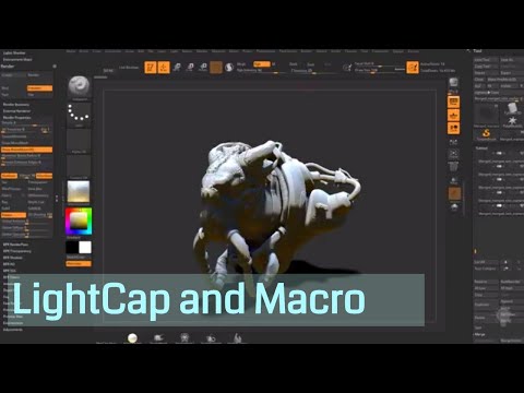

Hey I’ve found this script on a Michael Pavlovich’s tutorial:
Here is the tutorial:
Here is the script:
https://drive.google.com/file/d/16jBGUMboiBhI4zx1ZHRyWqsz0BH_0Wd0/view
Hope it helps !
cheers
