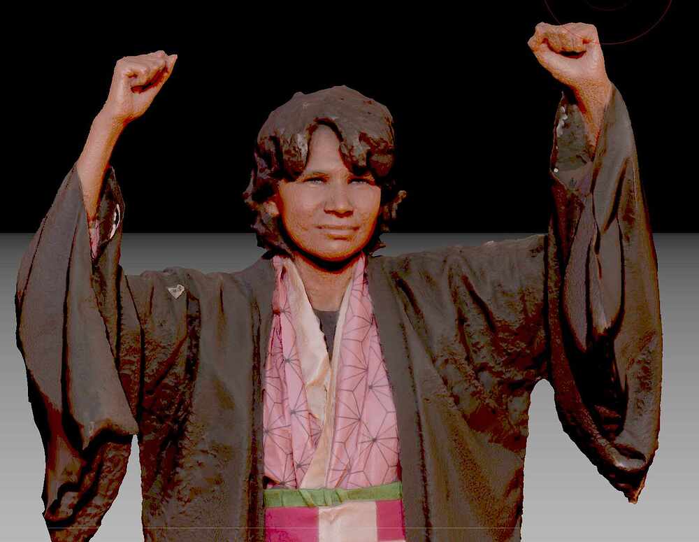

Here’s an example where I used Split and Merge quite heavily to track down exactly where the mesh had errors (as identified by Geometry > MeshIntegrity). The model looks okay at full resolution in ZBrush:

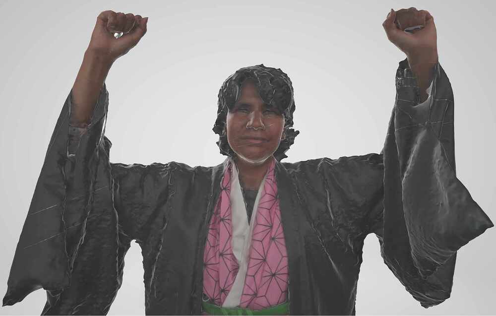

But, after decimating it, every place I used Split and Merge becomes very visible:

Regarding seams, this will generally occur if you sculpt over the edge of a piece of mesh separately from a surface it’s supposed to form a continuous surface with. You should try to either keep sections of mesh that are supposed to be one unbroken surface together in the same subtool or be prepared to do some cleanup.
