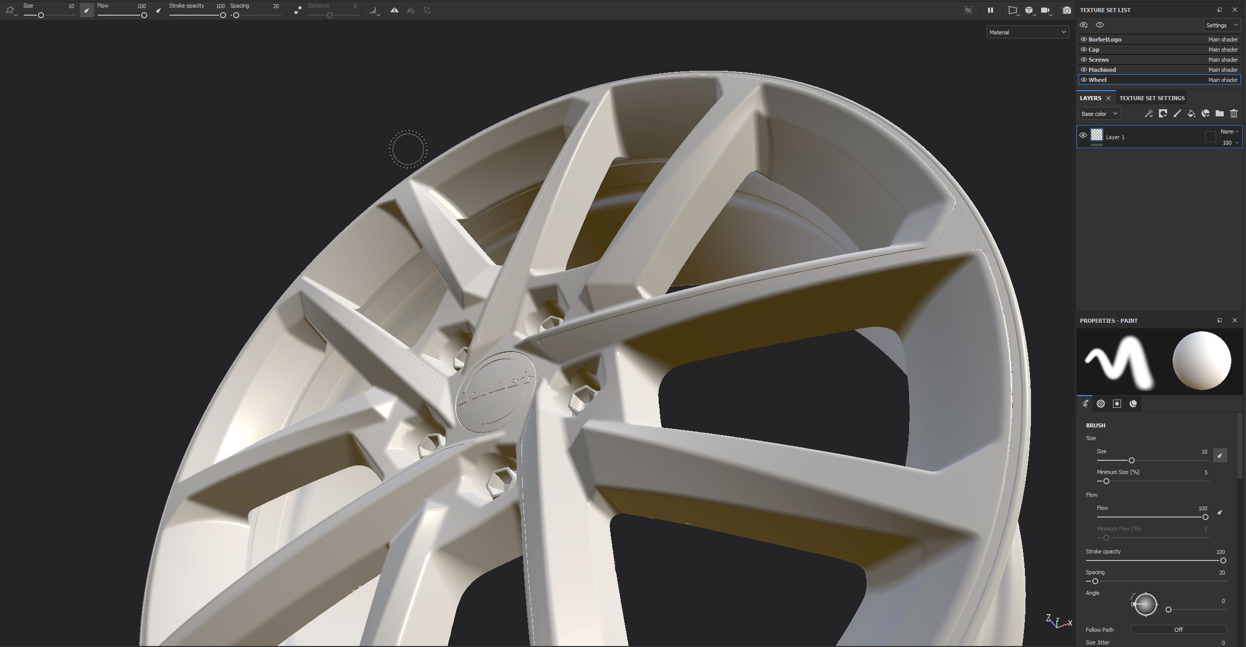

Hi there,
trying hard to get my highpoly wheel export ready from zbrush to substance painter.
There are no texture maps or similar on the model.
I just did some modifications in zbrush with the modeling kit and it´s brushes.
There is no way to import the model like it is directly to substance with its auto-UV creator. It just crashed.
So I had to use ZBrush for it, I guess.
The wheel is imported from Autodesk ALIAS to ZBrush.
Out of this reason the data is quite dense.
The nurb model is quite clean modified to polygon-quads by zremesher.
But anyhow very dense.
Means, I got around 10 mil points.

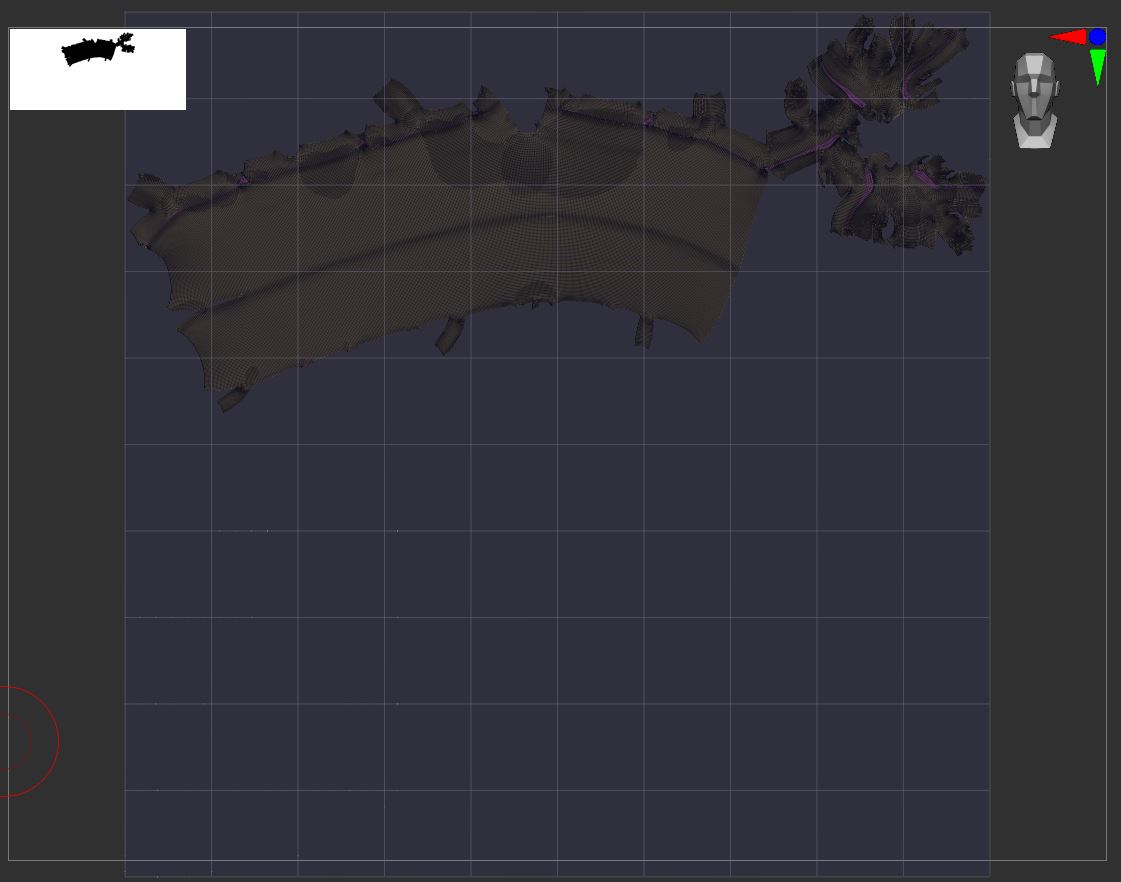

However that worked to get a more or less unclean unwrap.

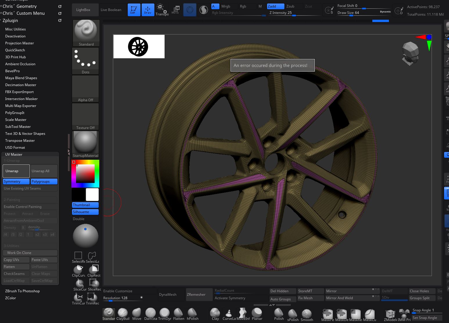

When I tried to keep my polygroups UV Master went crazy and stoped process.

Finaly I did it, but if I turn on polygroup option I blased it.
Also if I try to help manually with control painting (to protect and attract) will make UV master to give up.
Also from the unclean unwrapped version a cannot copy and paste the uv´s to the original version, because it doesn´t match the geometry. like ZBrush told me.

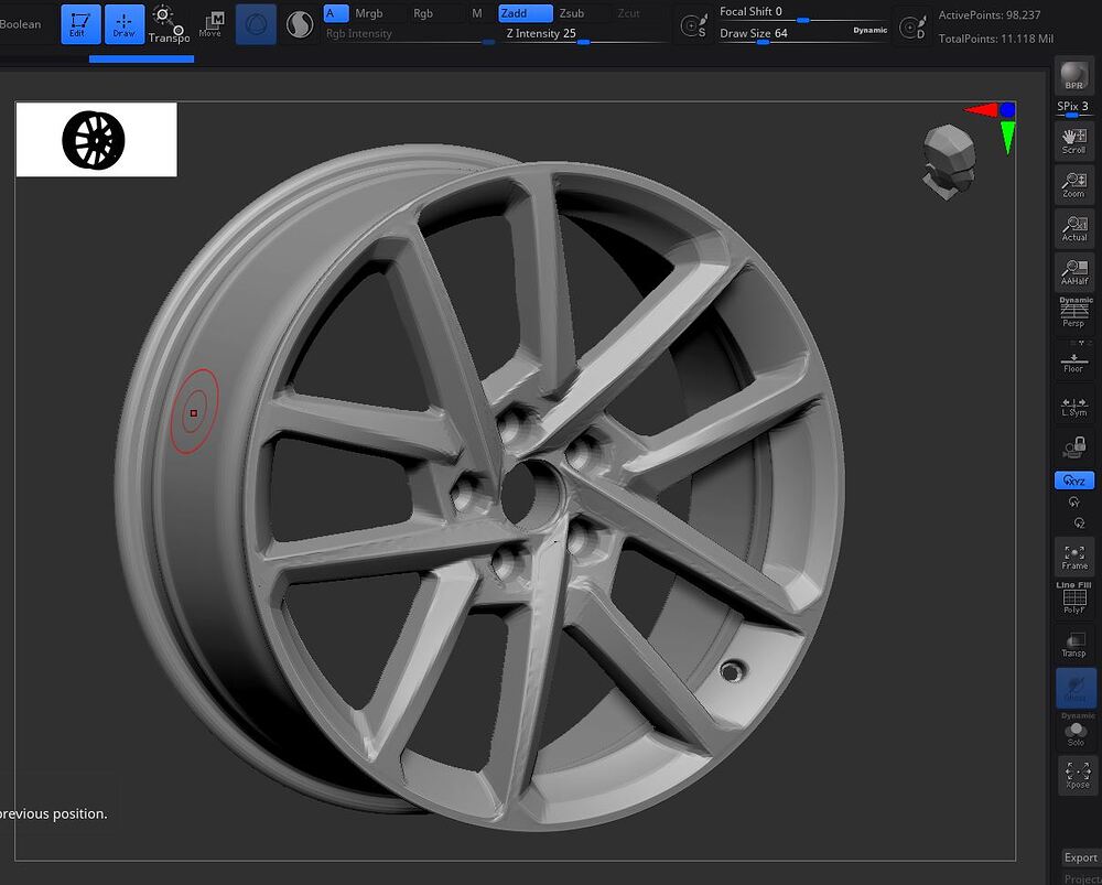

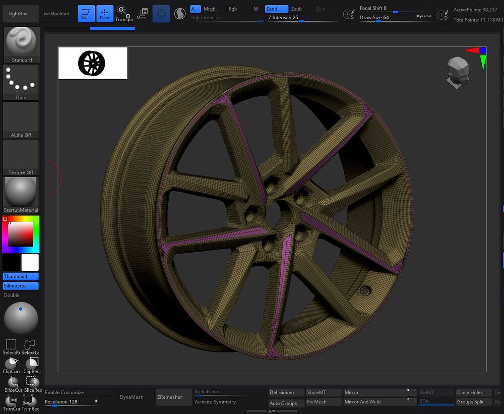

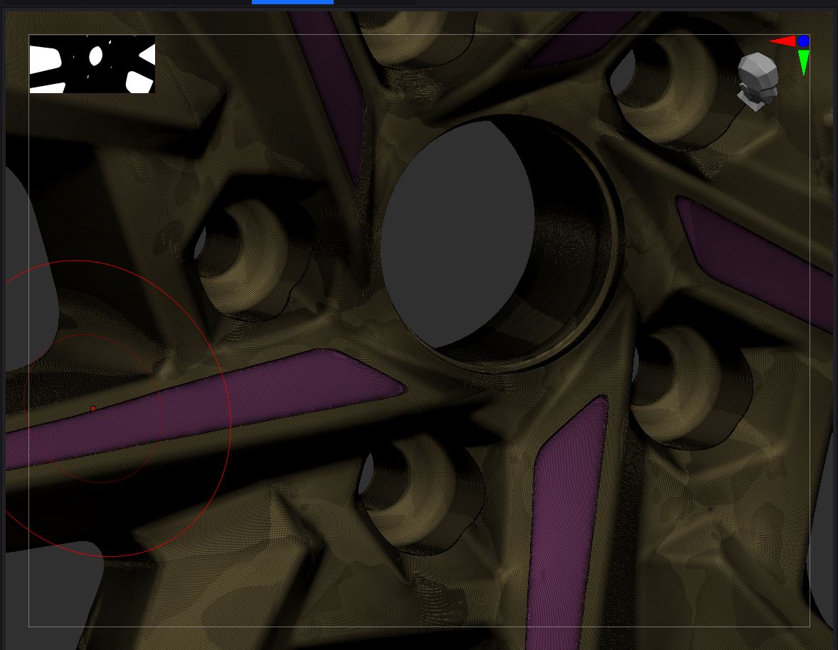

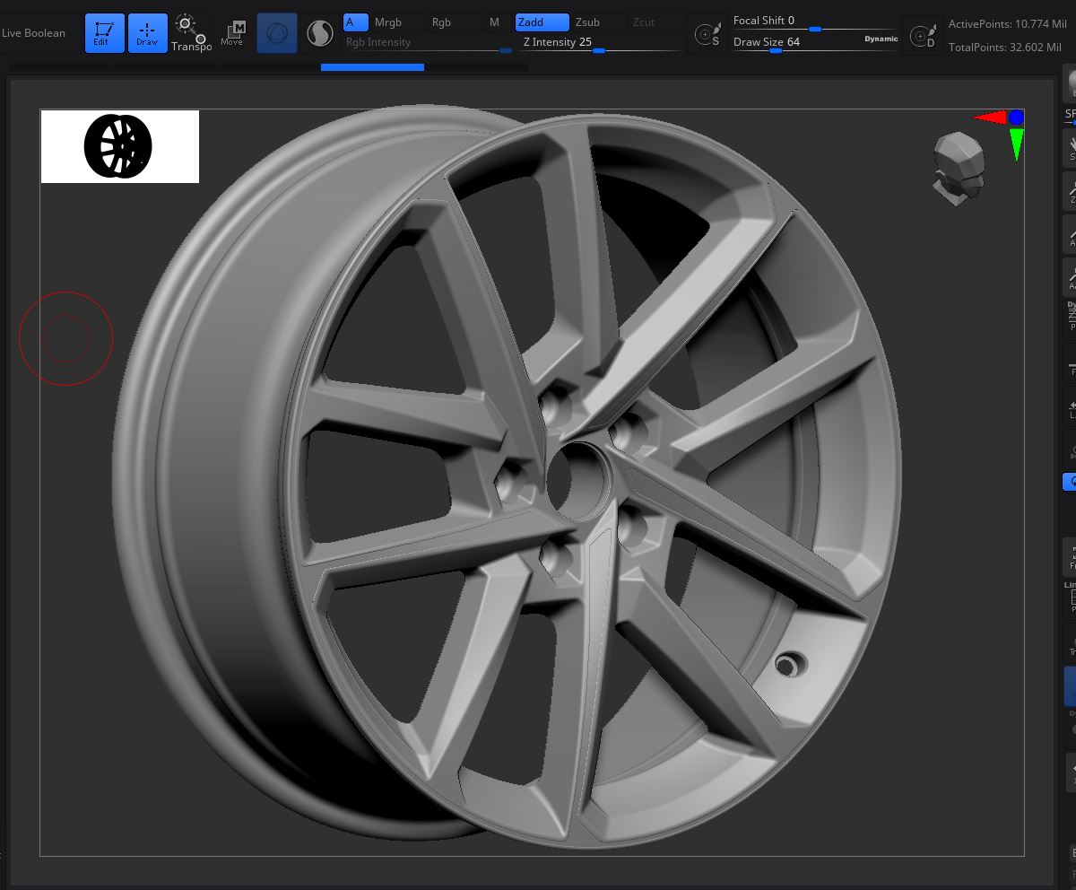

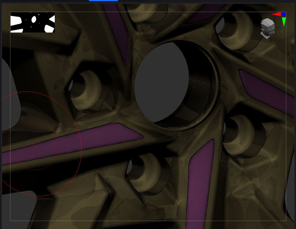

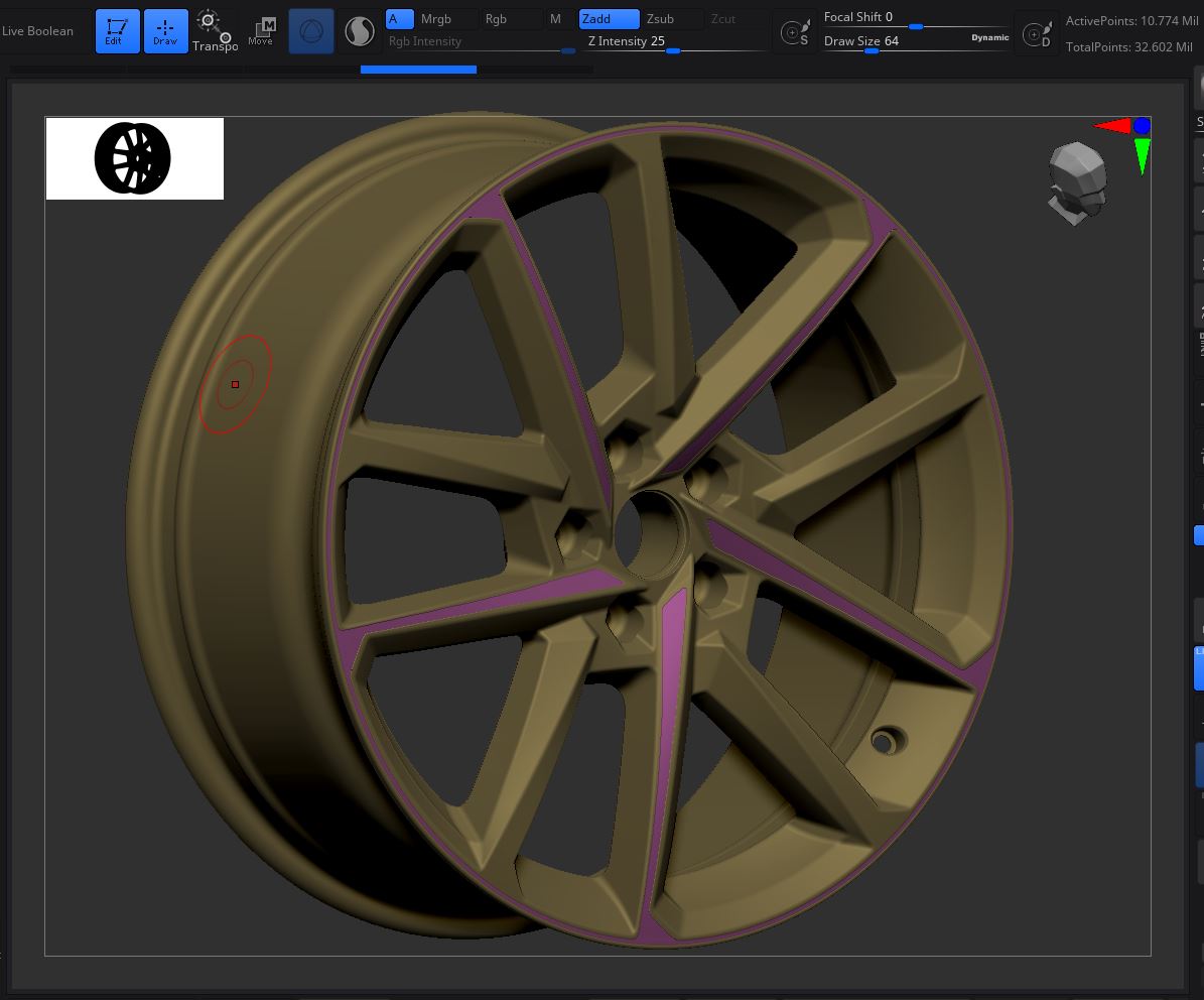

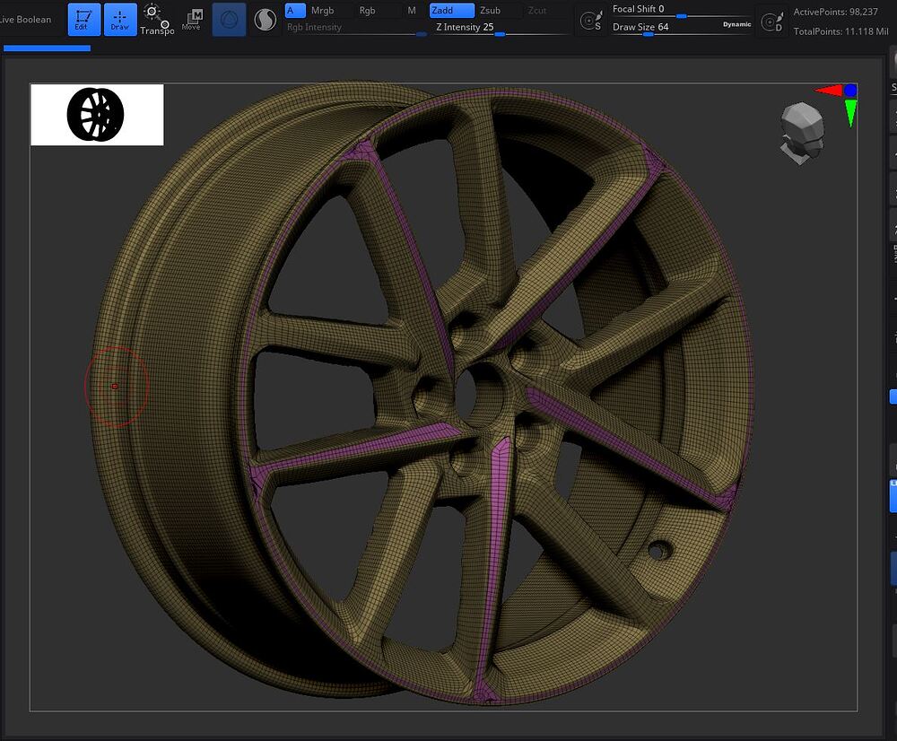

Here are the screenshots from described process so far:

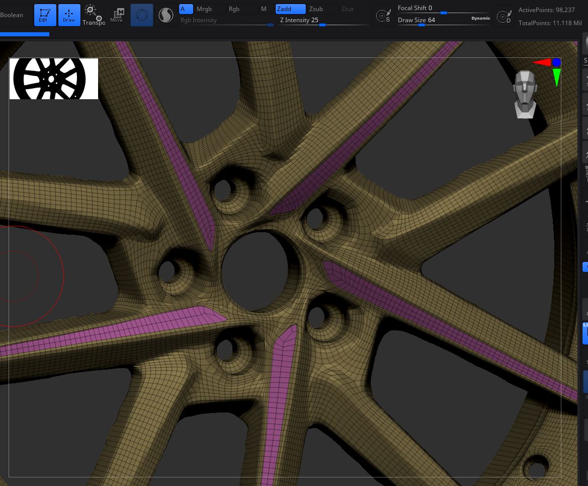

What your model does have going for it is nice, crisp form. With some work, you should be able to convert all the planes to nice cleanly defined polygroups. The exception to this is that very fine inset along the edges of the magenta polygroup in the screenshot. That detail is too fine, will complicate the form and never survive the low poly conversion. It would be better to eliminate this, and add it back in after redrawing the topology. With cleanly defined planes and polygroups that would be a simple low-poly modelling operation.
ZRemesher can do a pretty good job at finding the edges with “Detect Edges” on a crisp model if the form is simple enough. However, your form here is complex enough that you will probably need to cleanly define polygroups with borders that fall along the edges of your planes and curves where you want crisp edges, and use the “Keep Polygroups” option.
ZRemesher has an effective polycount limit itself. It may be necessary to decimate the model first to put it in reach of that feature. Please also be aware that no auto-retopo solution can draw optimal topology the way a human can. In some situations it may be necessary to manually retopologize the model. I recommend a hybrid approach letting ZRemesher do the heavy lifting, and manually correcting problem areas.
The more cleanly you can define your polygrouping, the better results you will get from ZRemesher. Your options here:

  • Places where the edges break down during the ZRemesher process are usually due to local issues with the topology. Common problems include tiny fragments of different polygroups that occur along the borders but may not be visible to the naked eye. Run a smooth brush along the borders or turn on Dynamic Subdivision to smooth those borders and you may see what the issue is. It may be necessary at points to redraw the topology in some areas so ZRemesher can more cleanly find the borders.
  • ZModeler is a good tool to touch up small problem areas with operations like Point> Stitch and its polygroup functions to clean up your polygroup borders.

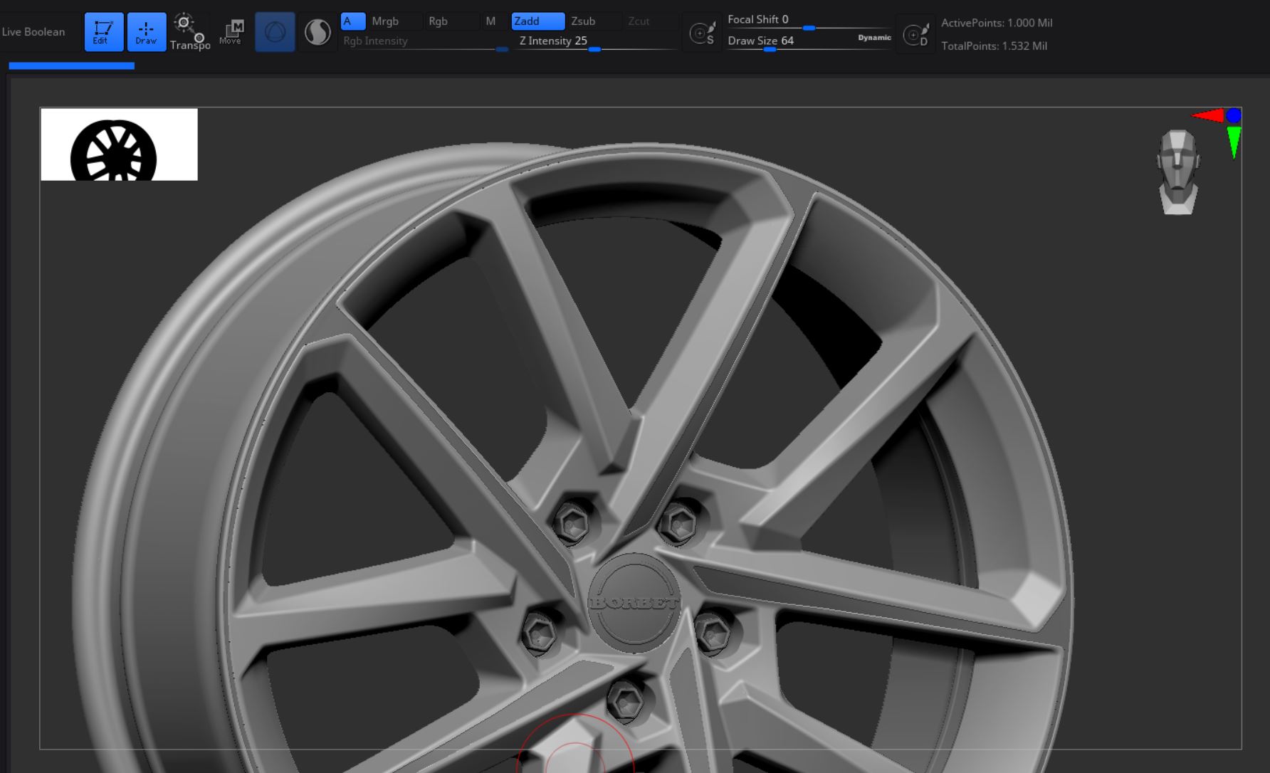

In meanwhile I handled it, to bring a 1.5 mil model to substance.
I really have no idea, why it worked this time.
It took 20 min but anyhow doesn´t crashed this time.
