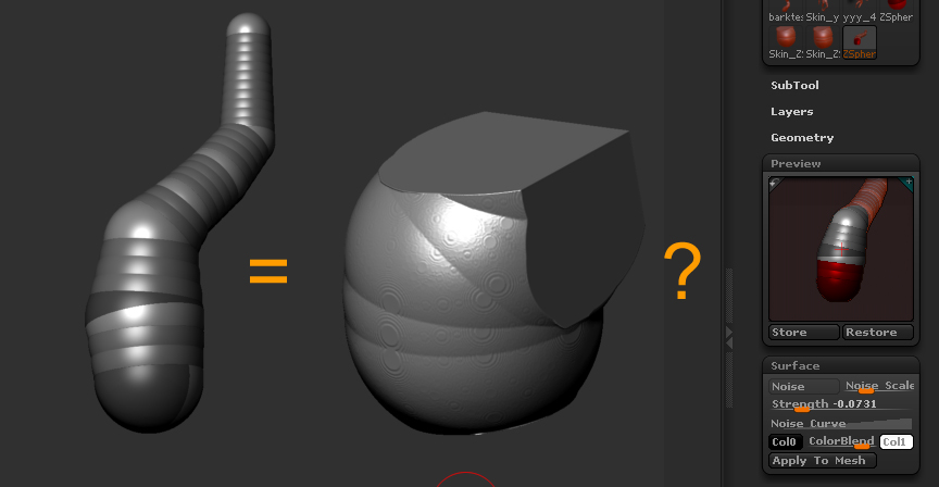

I’ve been getting strange errors in 3.5r3 which were not in 3.5r2 using unified skinning, there seems to be a calculation problem or “empty spot” in the negative -x-y(possibly -z). If you look at the preview window and compare where the errors are occurring the happen in the lower left of the pivot point, i’ve had this happen with different mesh’s all made with zbrush. I’ve even been able to replicate using the primitives converted to pm3d and tilted so they are crossing through the pivot point near that space.
The unified skin is creating a cube with a hole in the middle in that spot.

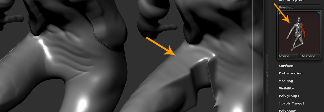

ALSO there seems to be another problem with unified skin not skinning past the bounds of the preview window. this has happened off of a simple zsphere chain. (example2)
yeah, Having the same problem here
glad i’m not the only one. i think i’ll have to try to avoid that area if possible. although no idea whats going on with that zsphere.
hey space thats odd almost looks like a subtraction from the clipping plane with the new remesh feature another new bug or anomaly that we have to avoid now… lol…:wink:

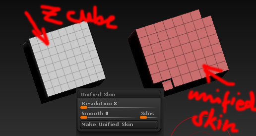

Yeah simply try to unify skin the simple Zbrush Cube.
take a look:
[cube.jpg]
The R2 Release does not seam to have these issues.

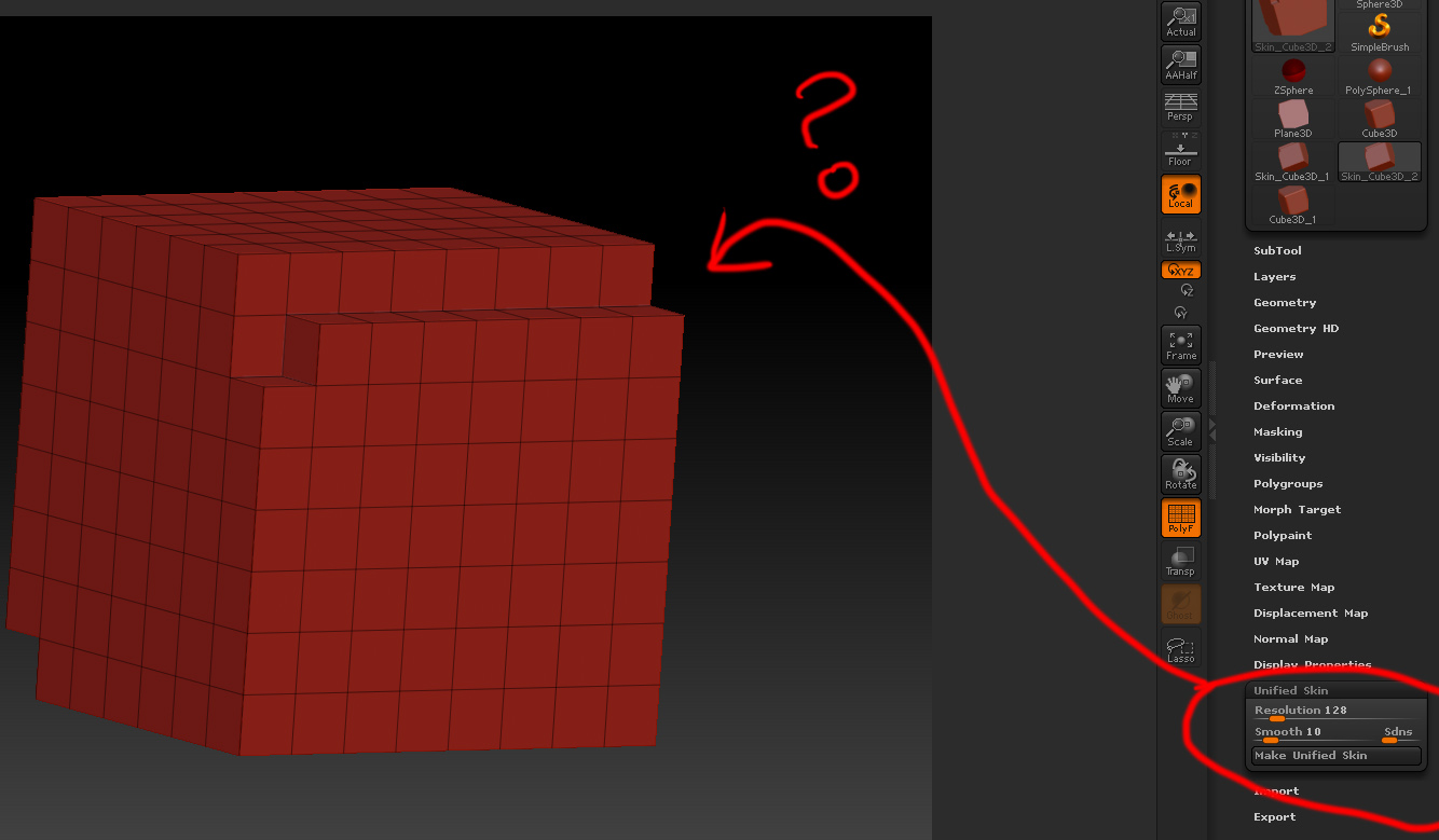

Having the same EXACT issue here when using unified skin on a cube3d. :cry:

That’s not what it’s about. Of course it’s not hard to get an 8x8x8 box into ZBrush somehow.
The point is there is a bug with the unified skin in R3.

I was having the same problem and after a bit of tweaking found that this problem only seems to occur when you set the resolution to 8.
Changing this to 16 seemes to work for me, not sure if you guys get the same?
