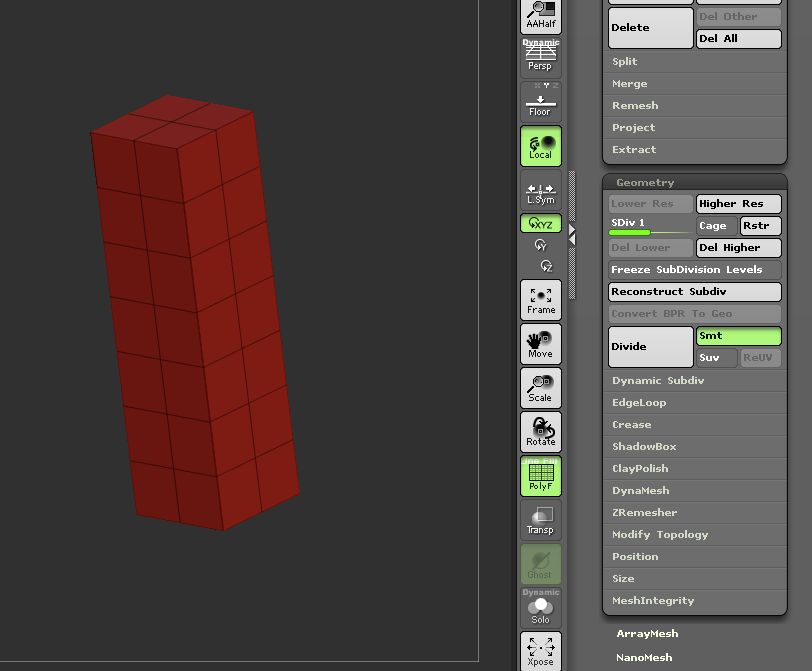

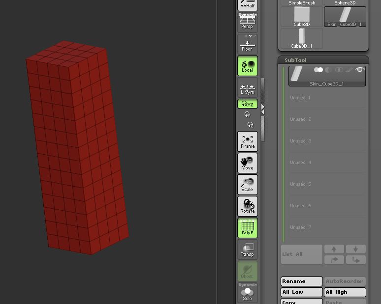

  • I can set my resolution at lowest only 16 (not 8 as he says in the tutorial)

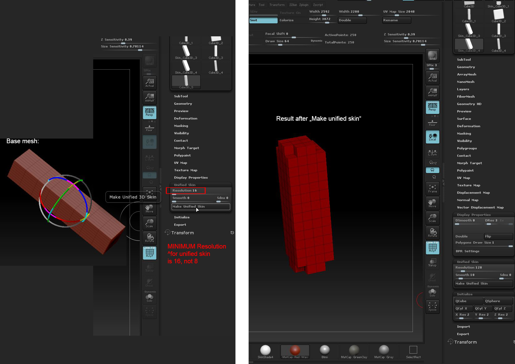

  • but most important, my newly created “unified skin”-object has wrong topology (see attached screenshots).
    (one is the result and the other two compare the beginning of video and my own test.
    (It doesn’t matter if I am in Edit mode or not.)
unified skin from poly cube 2 - Projection Master with Sebastien Legrain - Part 1.jpg

Works for me, but minimum resolution is 16 now. You then “Reconstruct Subdiv” once to get 8. That is an old tutorial. Are you using version 4R7 P3 ?
Yes, I’m using 4R7 P3 (x64)…
That’s what I’m using and it works OK for me. Doing what I described above, these are my results.
That tutorial was made for version 3 I believe.
Lol… And I was thinking on ZBrushCore… That gizmo confused me, I guess… :slight_smile:
