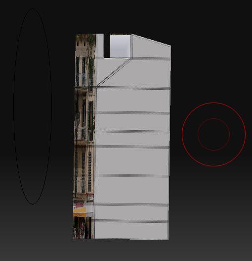

i post here a pic of and imported .obj file in zb. you’ll see the triangulation in the top part that comes from the extrusion of the top hut - it wasn’t there in max
when i (photoref) texture it and export it to max, the texture will show a distortion on this part.
there’s no way to work it over in max, no refining and then welding -
the only way i found is to make different meshes in max and combine them (soory, i know the terms only from my spanish app.) or attach them in zb.
