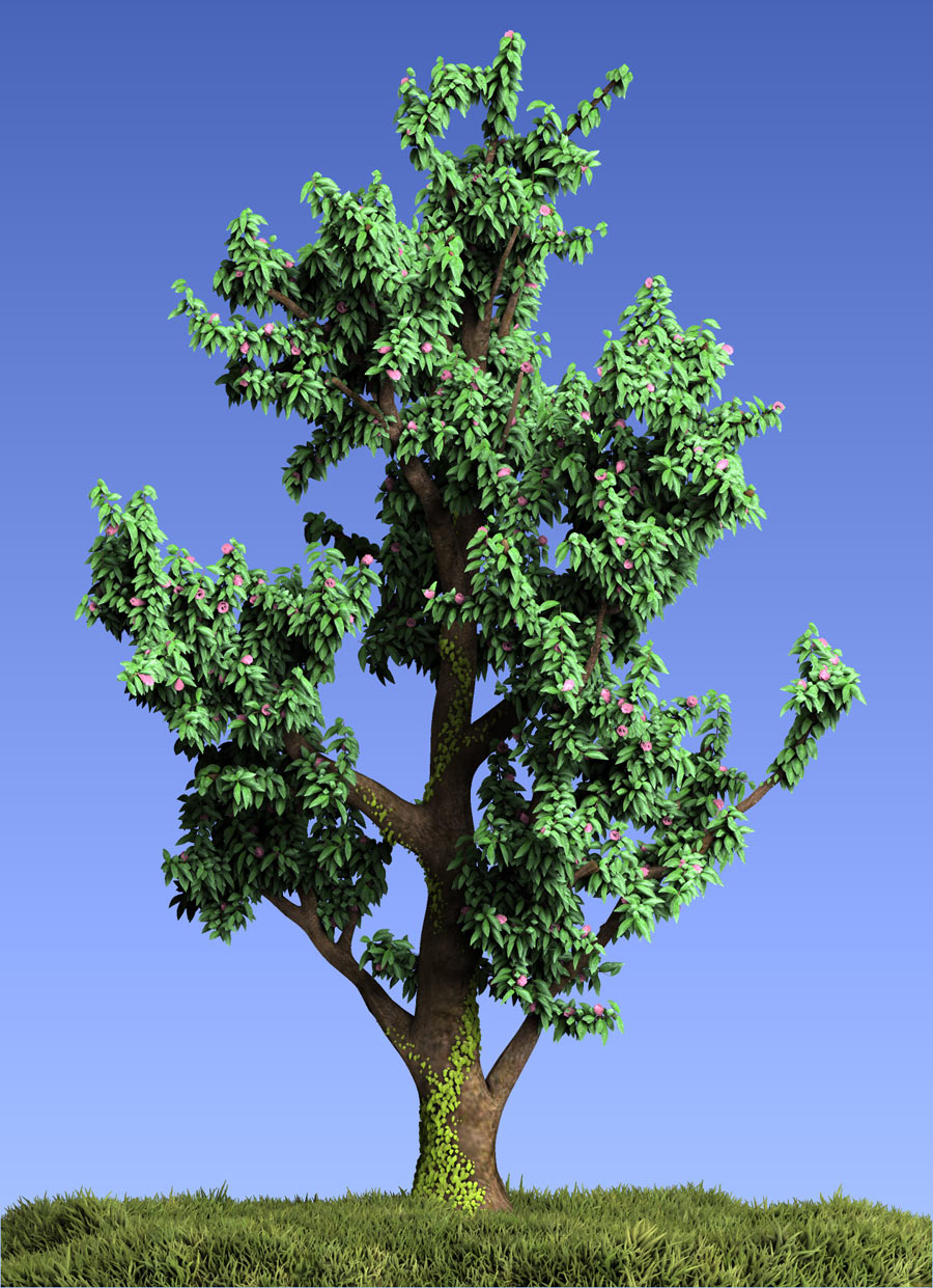

I have attached a link to download the ZBrush File for the image below if anyone is interested. The Subtools are saved as ‘PV’ and finals, The PV are the previews for the fibers for each element, and then the rest of the tools are the accepted fibers. In order to get a better render of the fibers when used as leaves I advise that you crease and divide them once before rendering to get a far more accurate shadowing.

@earthtriber: I hope your trees worked out well, and I agree this is a massive leap forward. You should have seen how I made some trees a few months back and how much time it took and now this, lol, makes me laugh in a crazy sort of way
@boozy floozie: Thanks loads. In order to use transparency you basically add full black to the texture where you want the object to be transparent as per the square leaf image above. You then select transparency under the texture preview in the texture palette.

@jubala: You can use any model as a MicroMesh insert. Try it with some of the primitive shapes such as the ring 3D.
@kevphil: The roots were made with Zspheres, as well as the main tree before the smaller branches were added using the FiberMesh. I need to give some time to using the FiberMesh for hair but been carried away with the foliage so far.
