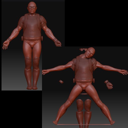

How can we transpose a model, and all the subtools too?
[transpose.jpg]
as you can see from my example, I have loaded the demo soldier into Zbrush and attempted to pose him…
only his naked bits like to move :o … how might I keep him decent?
I want to port my models into Zbrush and paint cloth geometry on them, and then later use them to pose in a Zbrush painting.
I have also tryed cloning all the Subtools, and adding them onto the main mesh… I get the same results.
The only solution I can think of is to port him back into blender and boolean all the cloths to the main mesh.
well either than or rig him, and pose him there, then port him back to Zbrush for my scene.

Any chance that switching subtools and trying “replay last stroke” might work?

Hello billrobertson42!
YOur method works!!
Thank you verry much for this :slight_smile:
This works great!

Using this method you can only rotate 1 armband into place on this particular model. If every subtool has it’s own subtool “layer” it works great. I’m sure there will be a fix for this soon.

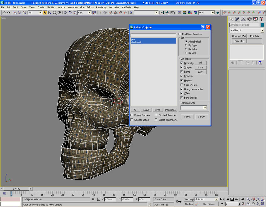

Well…I have stupit problem. In 3D Max, I have created Scull and Jaw, then those two meshes grouped in to one, called SCULL, exported as OBJ, imported in ZB3, then in to Subtool, press GrpSplit…and now I should have scull and jaw, BUT, nothing happens. Here is a screen from 3DS before grouping.
Strange
