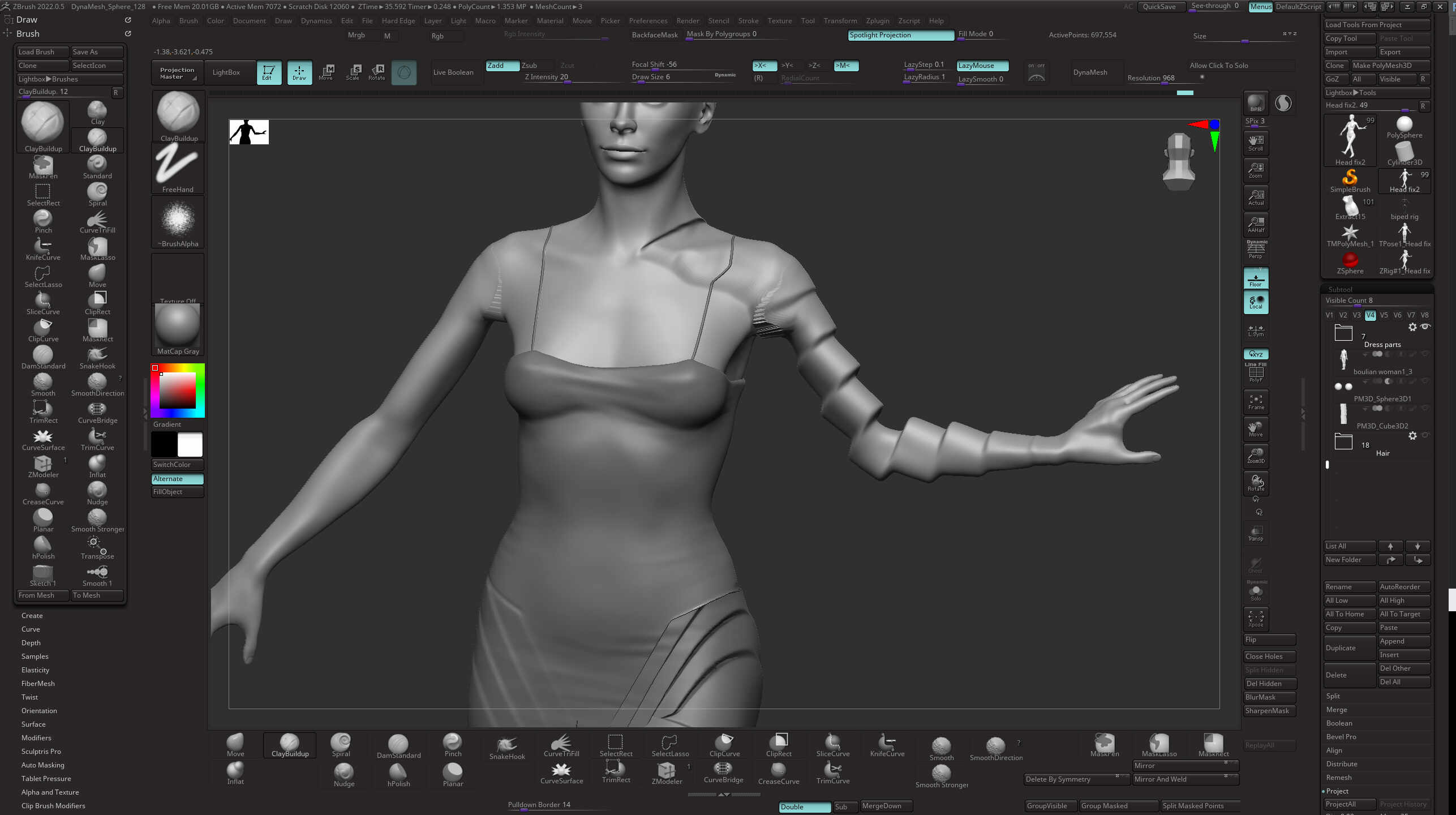

So this is my first time with transpose master using Zspheres and well… take a look at the picture. Its doing something], ehm unexpected. Any idea what I’m doing wrong?

That is a result of your mesh being too dense. For posing, zsphere armatures work best on low poly meshes. You will have to reduce your mesh resolution by using a lower subdivision level. You can still preview a higher resolution while posing on a lower resolution by using the Adaptive Skin procedure outlined in Rigging documentation. The following video might help also…

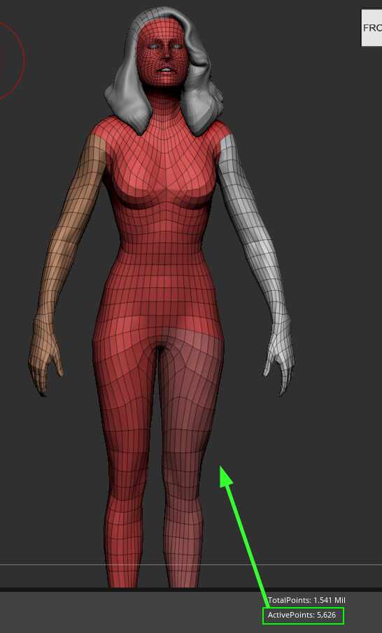

The video above should give you a pretty good idea. You should really watch it in it’s entirety. Also, see image below. This is one of those reasons why you should never delete your lower subdivision levels until you’re absolutely sure you won’t need them anymore.
