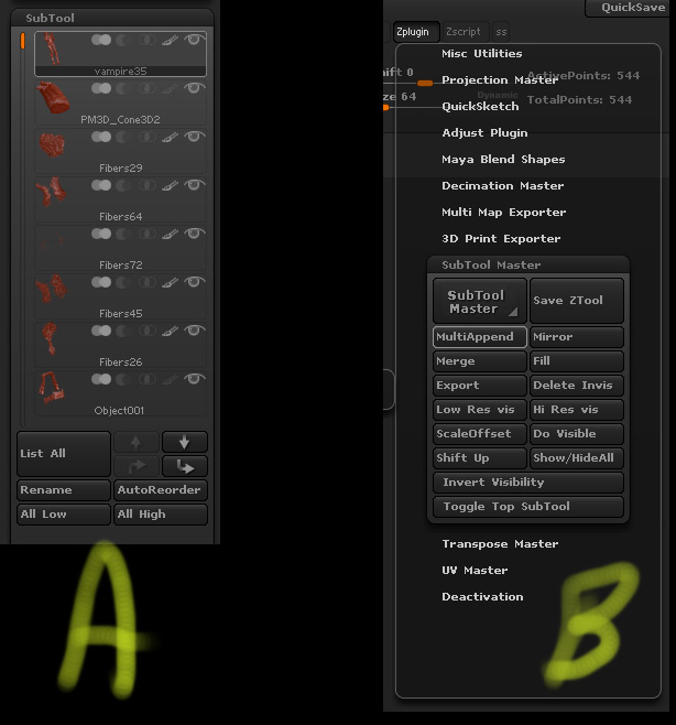

The below tips basically  means select the top subtool (see fig ‘A’) selected before entering the  tranpose plugin. Also have all subtools named differently. If the below  fails try multi appending your ZTL file into a new project from the  subtool plugin (see fig ‘B’).
