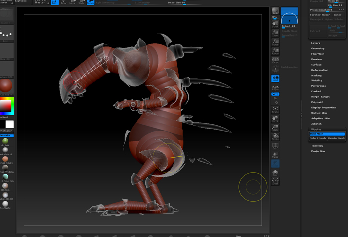

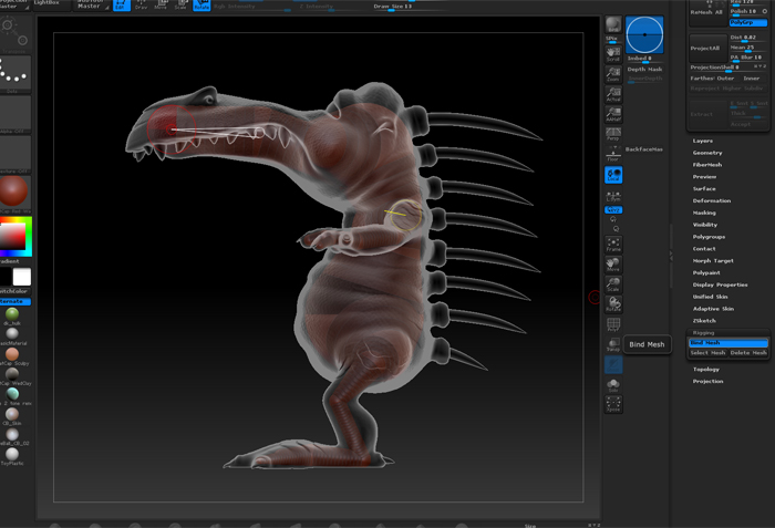

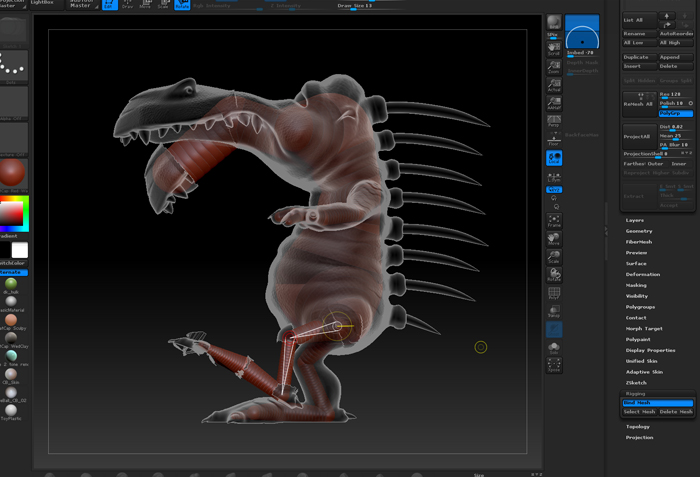

  • I’ve got a model with subtools
  • I use TPose Master - ZSphere Rig - build up the rig
Then I hit BIND MESH and try to move the RIG - then it goes like this:
Some rotation later:
One thing that happens is now after finishing the transpose: Some or all Subtools stay where they have been - or - part of the mesh stays where it has been and causes stretched polygons.
