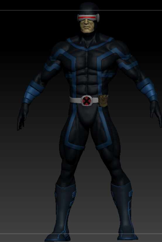

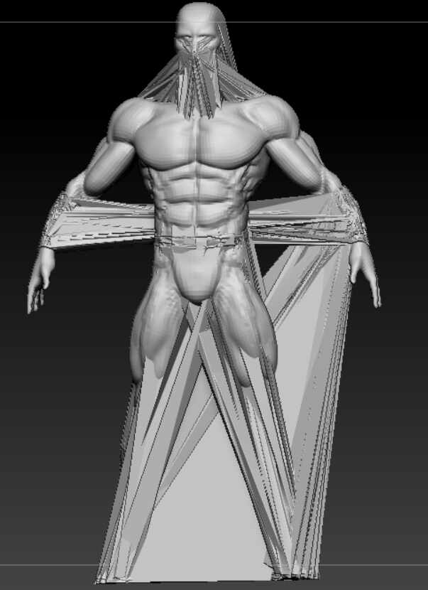

hi ,this is my model but when ı press the tpose master this happening
how can ı fix that!
how can ı fix that!
I guess two things.
Don’t use gizmo deform.
Double check hide mesh before transpose master. All mesh must be shown.
Hi @Yusuf_Yetiskin ,
To agree with @star0worshipper , it’s important that the point order of all subtools involved remain completely unchanged by any operation. That is why the Transpose Master documentation warns against the use of the Gizmo Deformers. Some of those will alter either the topology or the point order on the mesh and break the process.
In addition I recommend checking every subtool involved for issues with Tool> Geometry> Mesh integrity> Check Mesh. Any issues reported here have the potential to cause problems and need to be fixed before starting the process.
