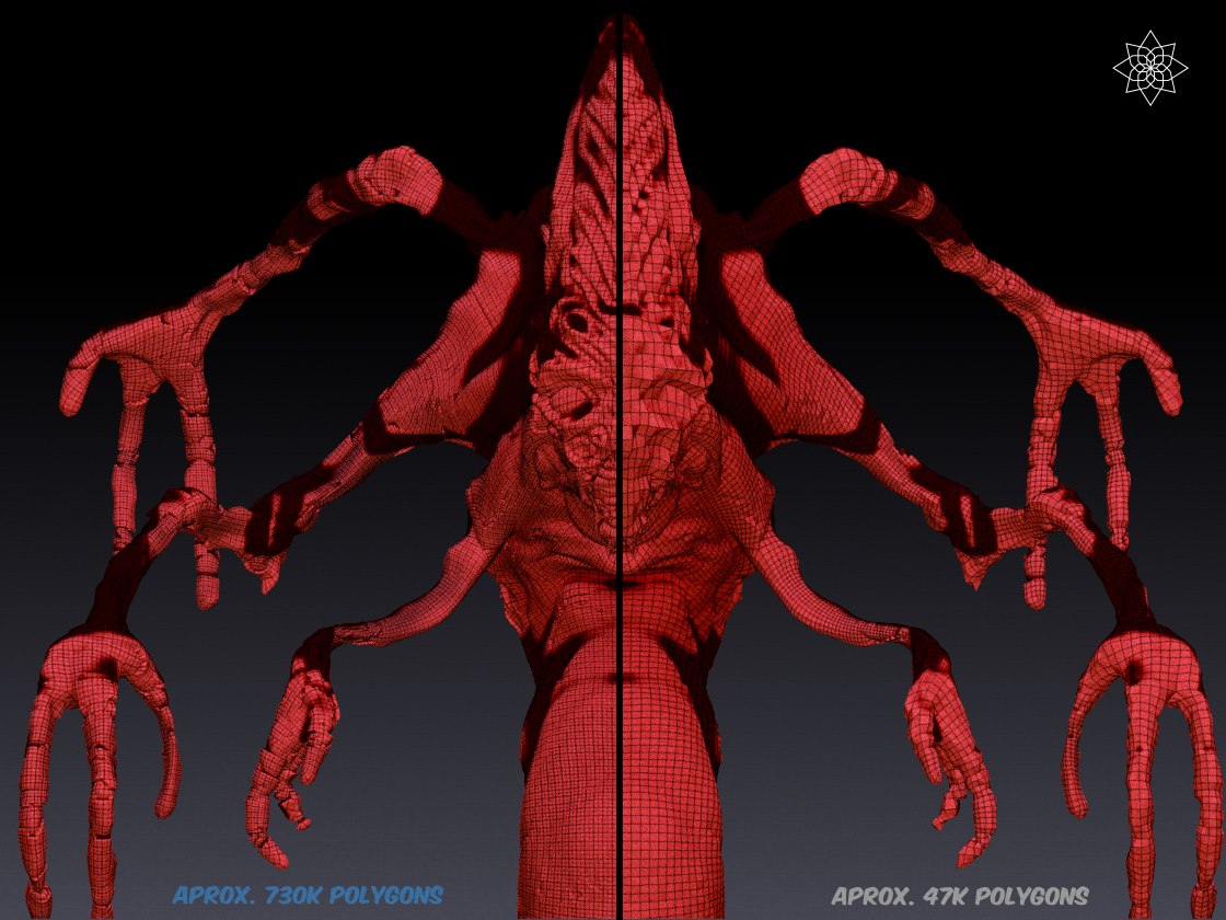

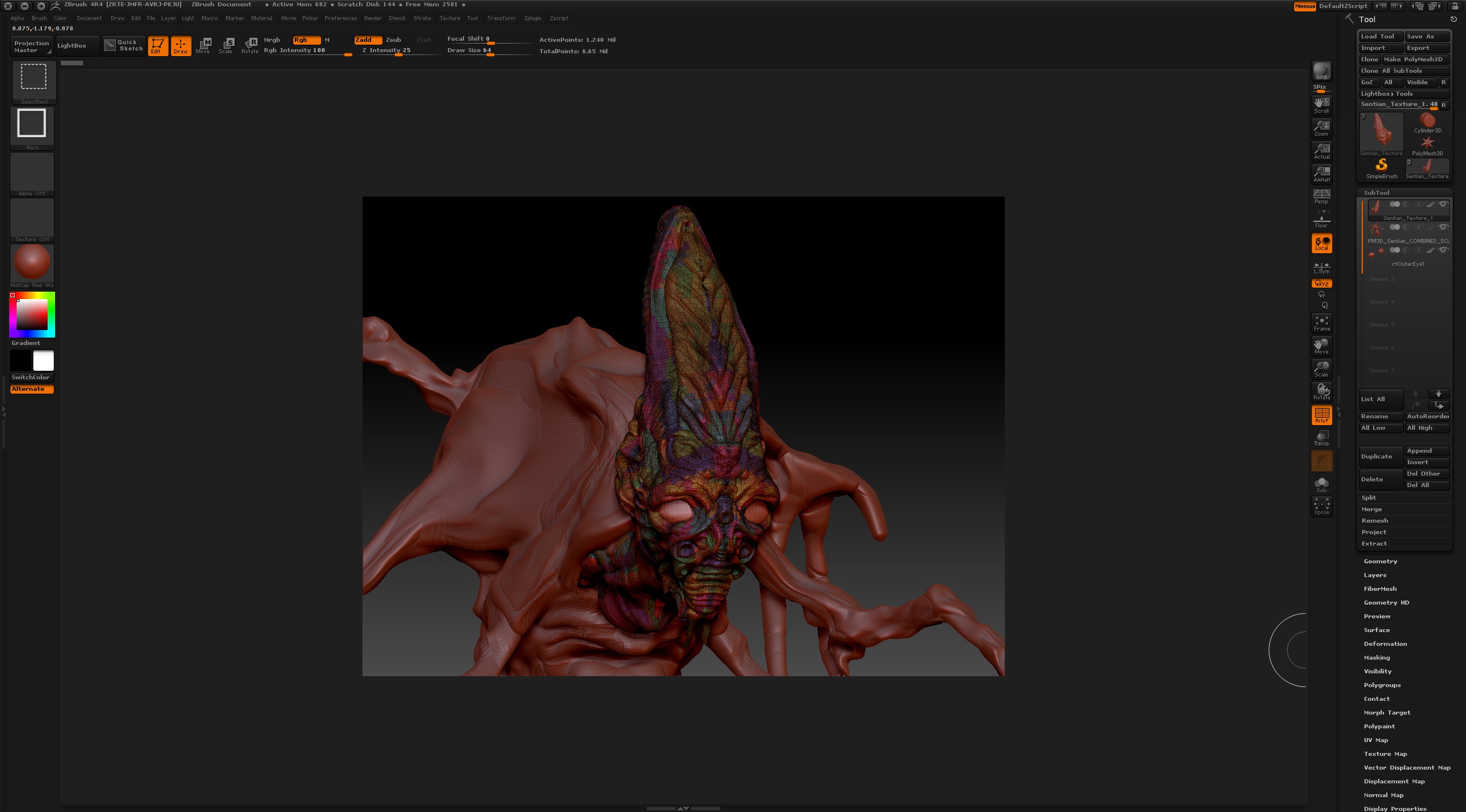

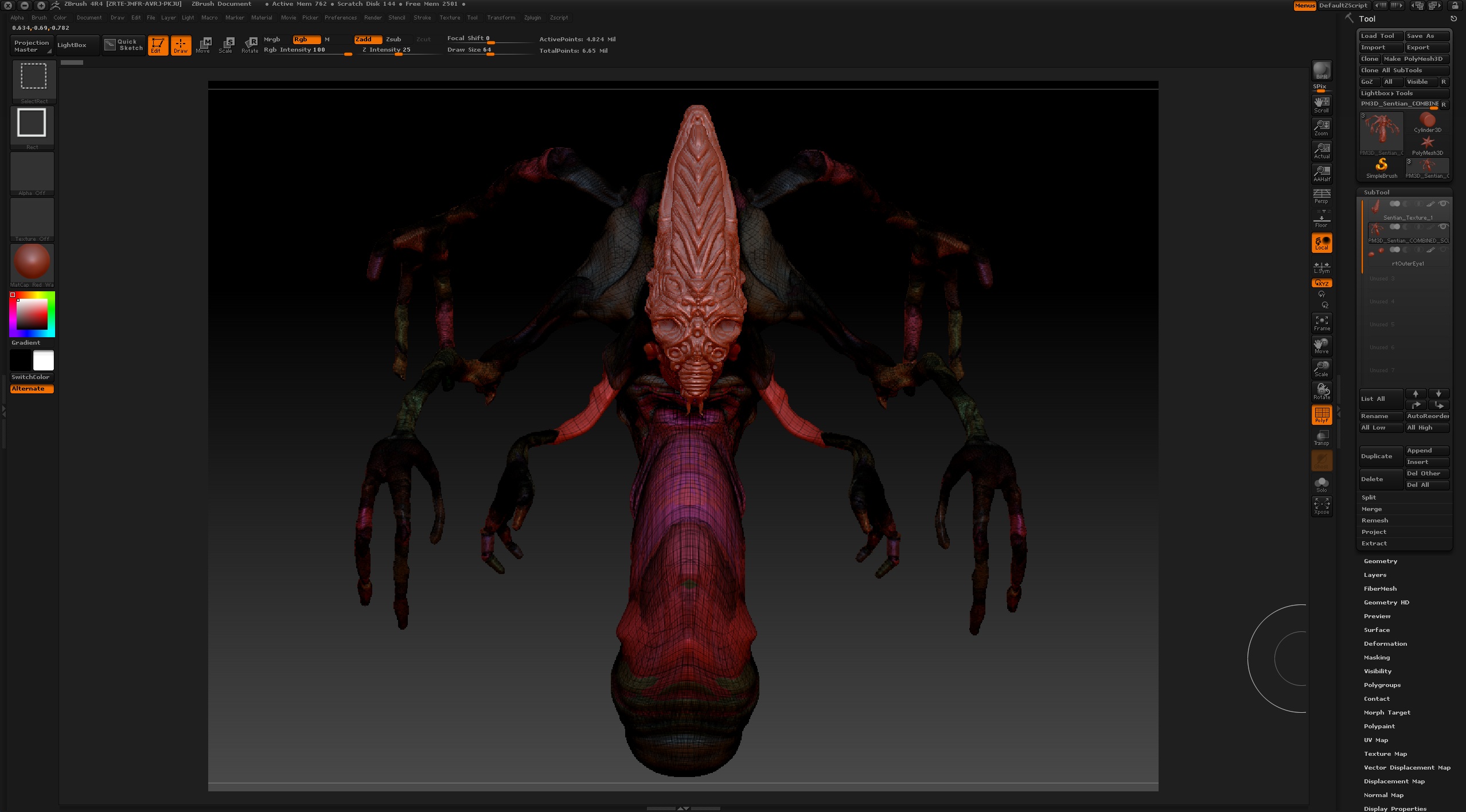

When I turn on polyframe mode I get this… which isnt pretty at all, and is almost guaranteed what is causing my issues. The polygons are overlapping, facing odd directions, and are way to condensed. I understand what I will probably have to do is re-topologize the model and clean up the model into better geometry and probably (for performance reasons) separate the model into smaller subtools/polygroups. I pasted a picture below of the model in its current form. What I am concerned with is that I did something wrong along the way and possibly need to redo parts of the body to make this work? I would basically like to keep most of the current detail but re-project the topology somehow, but really am lost on where to start… I tried watching some of the classroom videos but am not quite sure which route to take… Qremesher? Reproject? Decimation tool? I posted some pics of the model below for reference. Also note that I saved different versions of the model before I made all the drastic changes that are happening now so I can always revert back if needed. Thanks for reading through this, and hopefully I can get pointed in the right direction!
