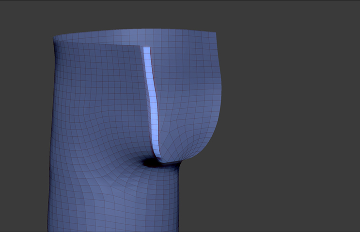

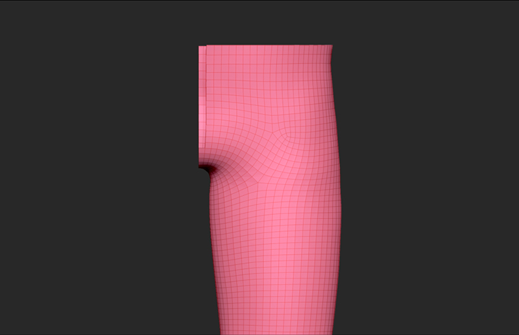

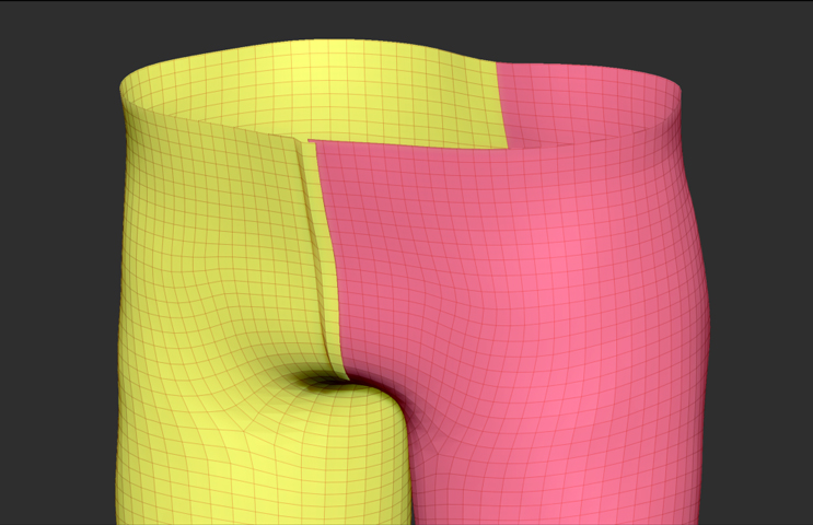

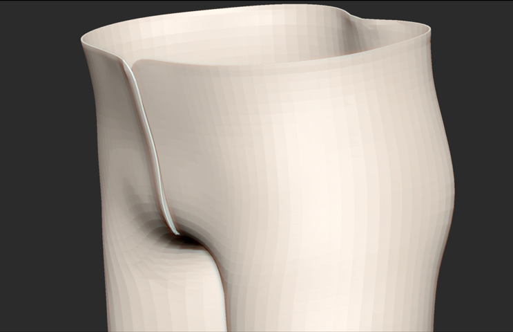

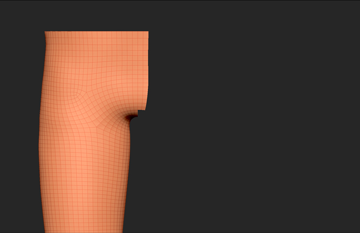

This worked for me:
Duplicate, then:
Mask and move ONLY the fly points:
Merge with weld:
Optional extract:
BRILLIANT! Thanks Thor. :smiley:
