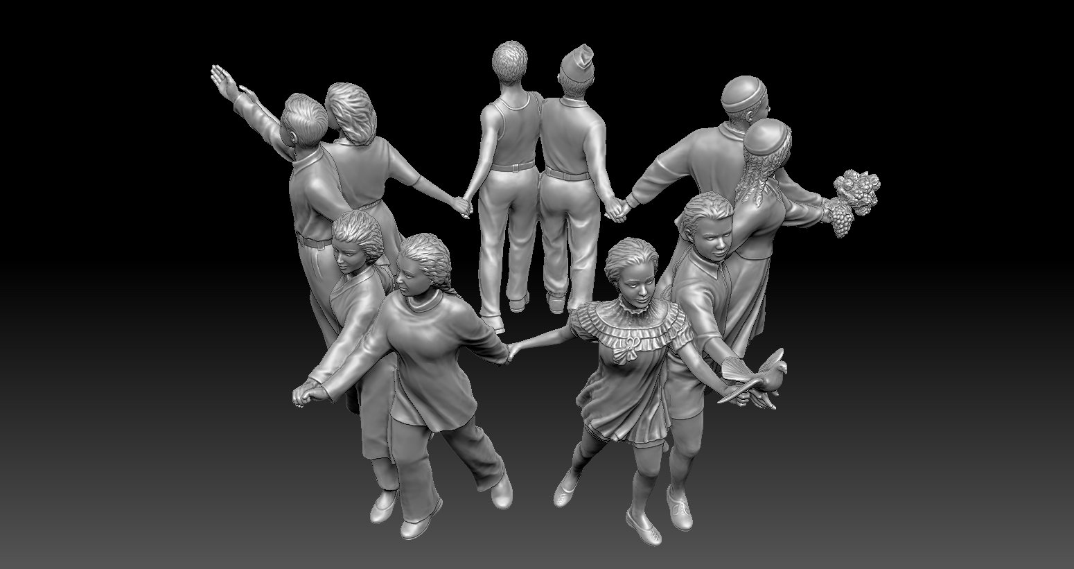

People, please help solve the problem. I am working on the reconstruction of a large monument and part of it consists of 5 pairs that holds the hands between each other. Initially, I worked on each pair separately. But as you can see in the presented images, all pairs are holding hands, that is, in the end it should be a solid model, which I then need to cut into technological parts for production.

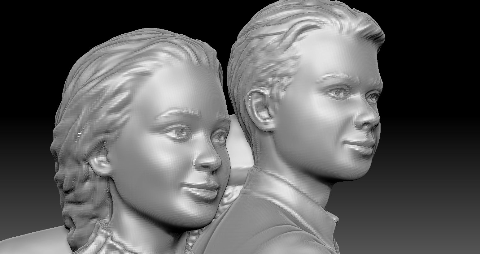

The big problem is that when I use DynaMesh, the number of polygons, with the maximum settings, is limited to about 4 million (you can see small polygons on the faces that are in the image), despite the fact that the basic number of polygons, before DynaMesh, was more than 65 millions. Ie a lot of details were lost.
And before the merger and recounting of the overall composition with DynaMesh, each pair was also used DynaMesh in process of creating, but the resolution was twice more.
So the question is, how can I increase the resolution of DynaMesh recalculating the model?
The figures are created in full size - approximately 1.8 meters high.
I also tried to increase the models by 2-3 times to increase the resolution of DynaMesh, but, unfortunately, the result does not change.
