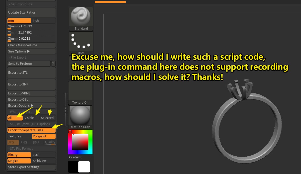

The plug-in command here does not support recording macros, how should I solve it?
Excuse me, how should I write such a script code, the plug-in command here does not support recording macros, how should I solve it? Thanks!
only a single plugin can run at once, so it gonna record what you press when recoding the macro, but when you execute the macro the very first [ipress] on All, / Visible / selected, will startup the 3d print hub plugin then the macro stop to run.
hope this helps,
Nicolas
Do you mean there is no solution?
yes, that’s it.
Thanks for your answer
