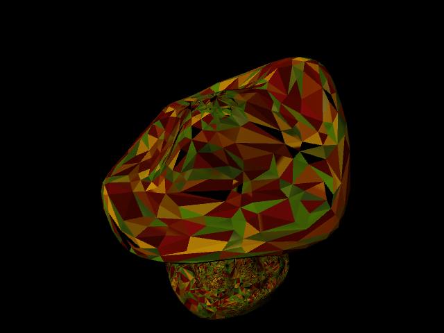

i have been trying to find out about the correct workflow for getting the polypaint texture that was painted on a high rez mesh BEFORE i have decimated the mesh because i have tried to load the exported texture in maya (see picture) but all get is the decimated mesh texture all messed up. i have selected "keep polypainting " in the decimation options and keep UVs . In essence this is what i have done so far.

is there another more simple way to get the hi rez polypainting out and into maya and mapped to the low rez mesh? i mean its impossiable to use the level 6 sub div in maya without it crashingtest.jpg

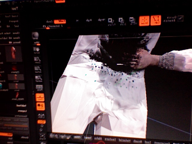

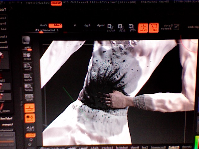

However it’s been replaced by a new one. Decimation Master
once the decimation takes place creates some strange effect
by creating a really blocky triangulated distorted version of the
original mesh. Here are some pics I uploaded, please forgive the
graphic nature of these pics. They are for a suspense film.

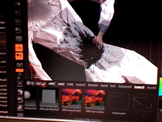

The 4th pic is how I’d like it too look once properly decimated.
Anybody have any idea what this problem is? Strange thing being is
even after it makes these images super blocky, the number of polygons
does NOT decrease!!
Thanks in advance gents…
Paul
