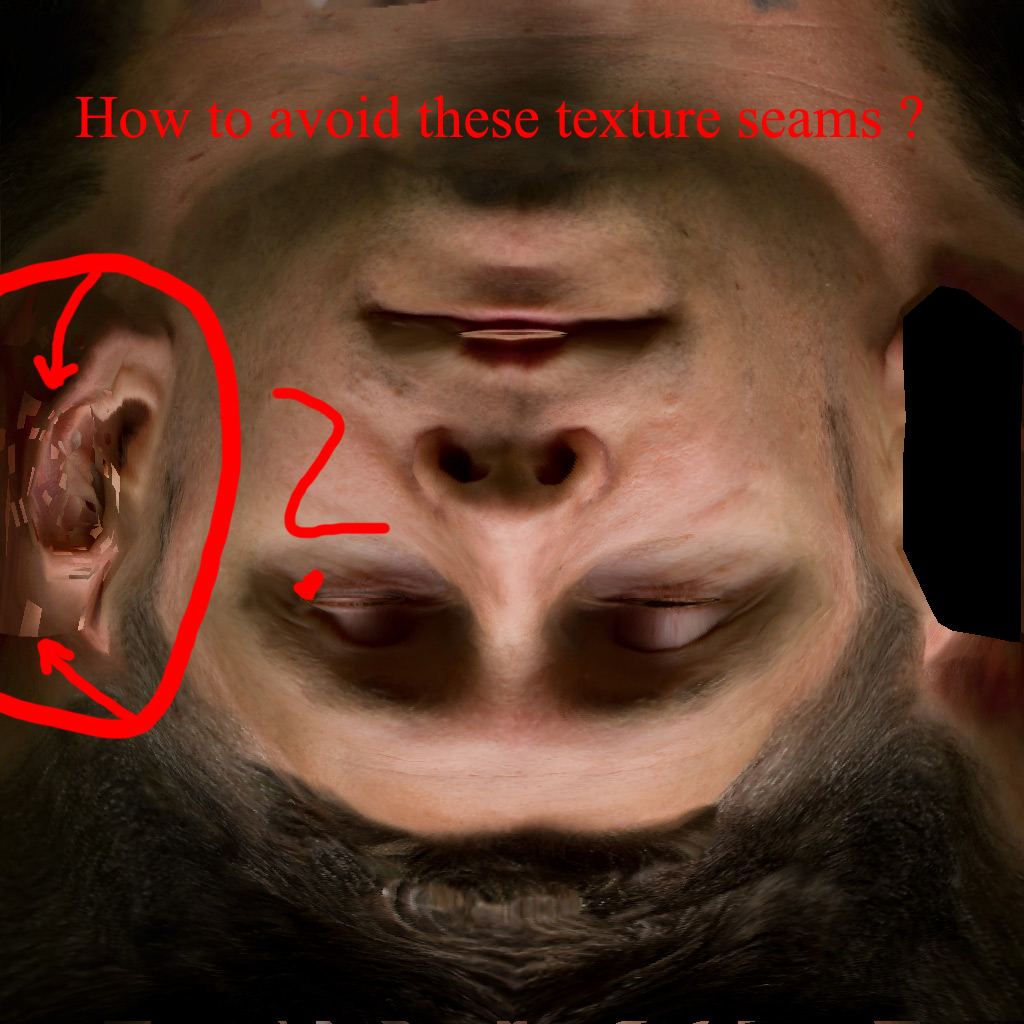

I unwrapped my character first in max. Exported inot ZBrush and just poly-painted on it.
After that, I created a texture map with Col->Texture
So far all looks good, but especially on teh ears I got ugly texture breaks.
Or it looks like seam-breaks.
I tried to click Fix Seams, but didn’t work.
So what can I do to fix that problem ?

below the image… I’ll try to post the UV as well later…
<img src=“http://www.zbrushcentral.com/pixo/atn.gif”>
and here is the uvw map:
Help - Help … maybe someone knows how I can fix that problem ?
hmm… well, I also would like to mention… that the weired looking broken texture seams appear already in zbrush when applying the texture map.
so it has nothing to do with the export… just wanted to mention that.
for me the unwrapped uvw map of the head looks ok… even at the area of the ear… so what is the problem ?
or better, what did I wrong and how can I fix it ?
thank you so much for every little help
you ve got overlapping faces in the uv. especially at the ears. that´s bad :wink: I think this should be the problem
u have a overlap face…if u are on 3ds max try to select (inseide the uv editor)an edge or face and activate the command “show overlapped face” if it show u some red face on your uv u have a inverted face…im sure u have sometings wrong near the ears zone :frowning:
