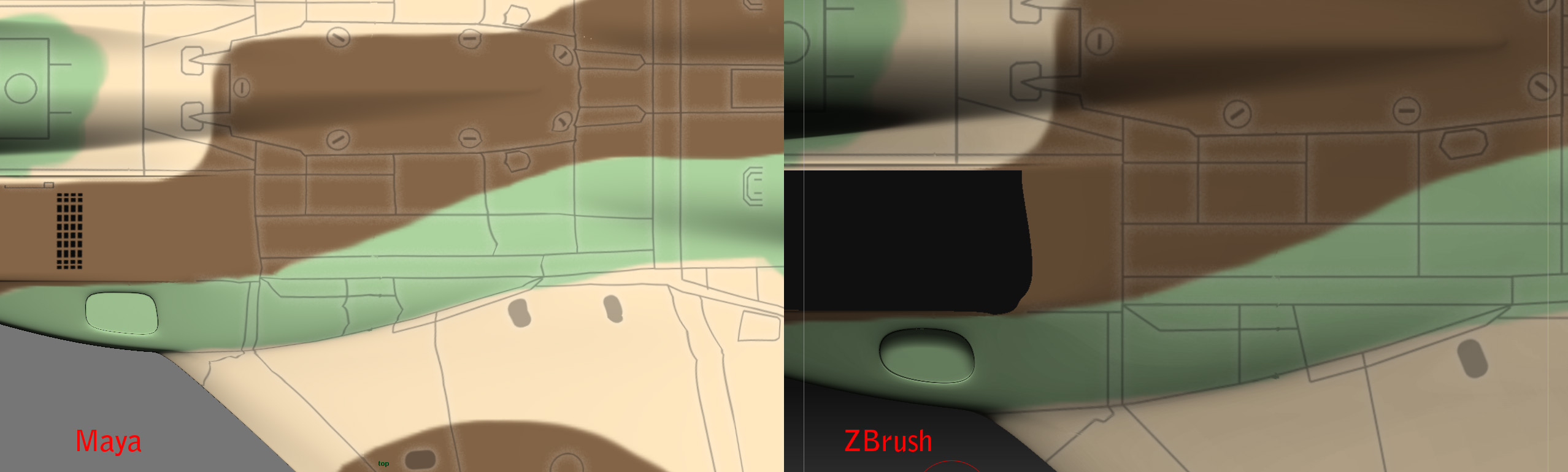

Hello,
For some reason when I’m making the texture in ZBrush on high subdivision level it looks terrific but as soon as I go to a lower subdivision level or to see the texture on the model in Maya it looks bad… (even if I smooth the model out in Maya)
It sits all right but the straight lines are not straight anymore, they are all twisted…
How come?
Thanks.

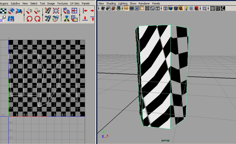

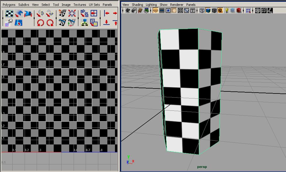

Maya, uses a texture system, where it triangulates everything (geometry and uv’s) to apply the texture onto it, so, if you don´t have clean uv’s, the texture will look odd
This mesh has stretched uv’s, maybe you’ll be able to see the triangle where the texture bends inside the face…
Hope this helps a little :slight_smile:
Oops sorry, I probably wasn’t clear.
I am not polypainting the model, I’m using ZApplink and Projection Master over an existing texture layout and UVs.
So the UVs are there and I’m not limited by the poly count or anything, I’m painting over the texture I already have.
So on high subdivision level the texture looks good on the model but as soon as I go to the lowest one or to see it in Maya it’s twisted…

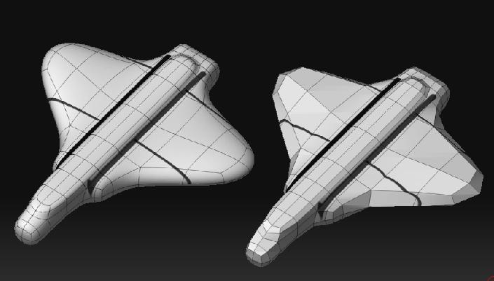

Think of the high res mesh as a inflated baloon… you paint on it some straight and beatuiful lines… it looks perfect!
And now… deflate the baloon…
Projection master and Zapp link are intended to work in the resolution (mesh resolution) for the final render…
Try texturing your model in your lowest subdivision level
[Plane.jpg]
