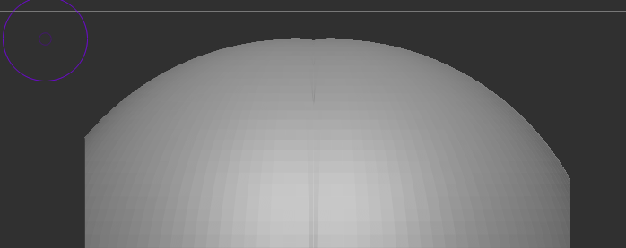

But still the middle edge loop is not melted correct. Do I need to add an edge loop?
It looks like your mesh was slightly off-center. That’s typically what causes seam issues like that.
Try moving your mesh towards the mirror plane slightly before performing mirror and weld, so that the problem geometry is cut off by the M&W operation. If it’s just a small problem area, pull the individual points across the mirror plane with the move tool, so that they are cut off by the M&W operation.
It may help you to visualize the mirror plane by switching on the floor grid with the proper axis active. Make sure the elevation slider in the Draw menu is set to zero.
