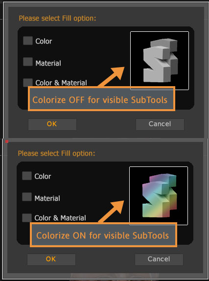

  1. In SubTool Master select the Fill option.
  2. In the Fill options dialog uncheck all the options or click the icon so that the icon turns gray. This will turn off ‘Colorize’ for the visible subtools. Clicking the icon acts as a toggle for turning Colorize on or off.

When I open Subtool Master and enter the ‘Fill’ dialog box, there are three choices (Color, Material, Color & Material). You must choose one. It doesn’t seem possible to turn all three settings off. Is this right? Clicking the icon has had no effect over here. Also, when I open Subtool Master, a menu opens that stops at the bottom of my screen at item thirteen ‘Invert (something)’ - the bottom half of the button is missing. Are there more than thirteen items? How do I view them?

In order to get the Colorize toggle feature I mention, download the latest version of SubTool Master from the start of the thread - you have an older version.

SNARK,
Check ‘Color’ will fill with the selected color, which you don’t want to do. Just use the icon to toggle the color on and off.
Thanks, Marcus!
That was it. Works fine now.
