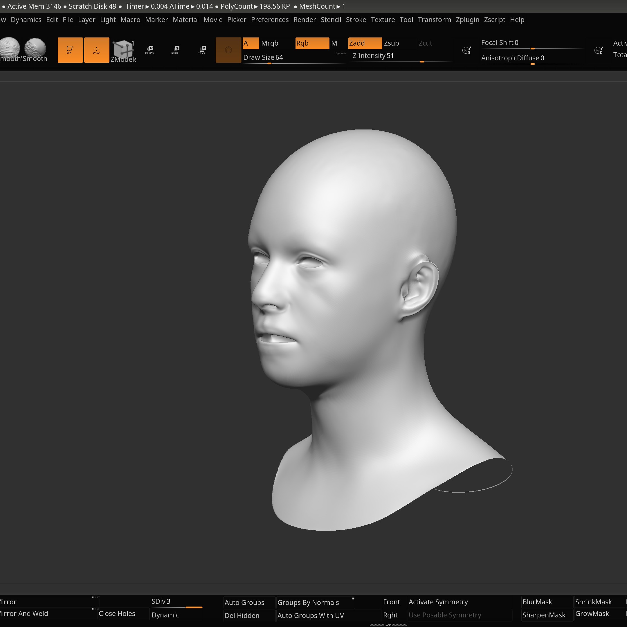

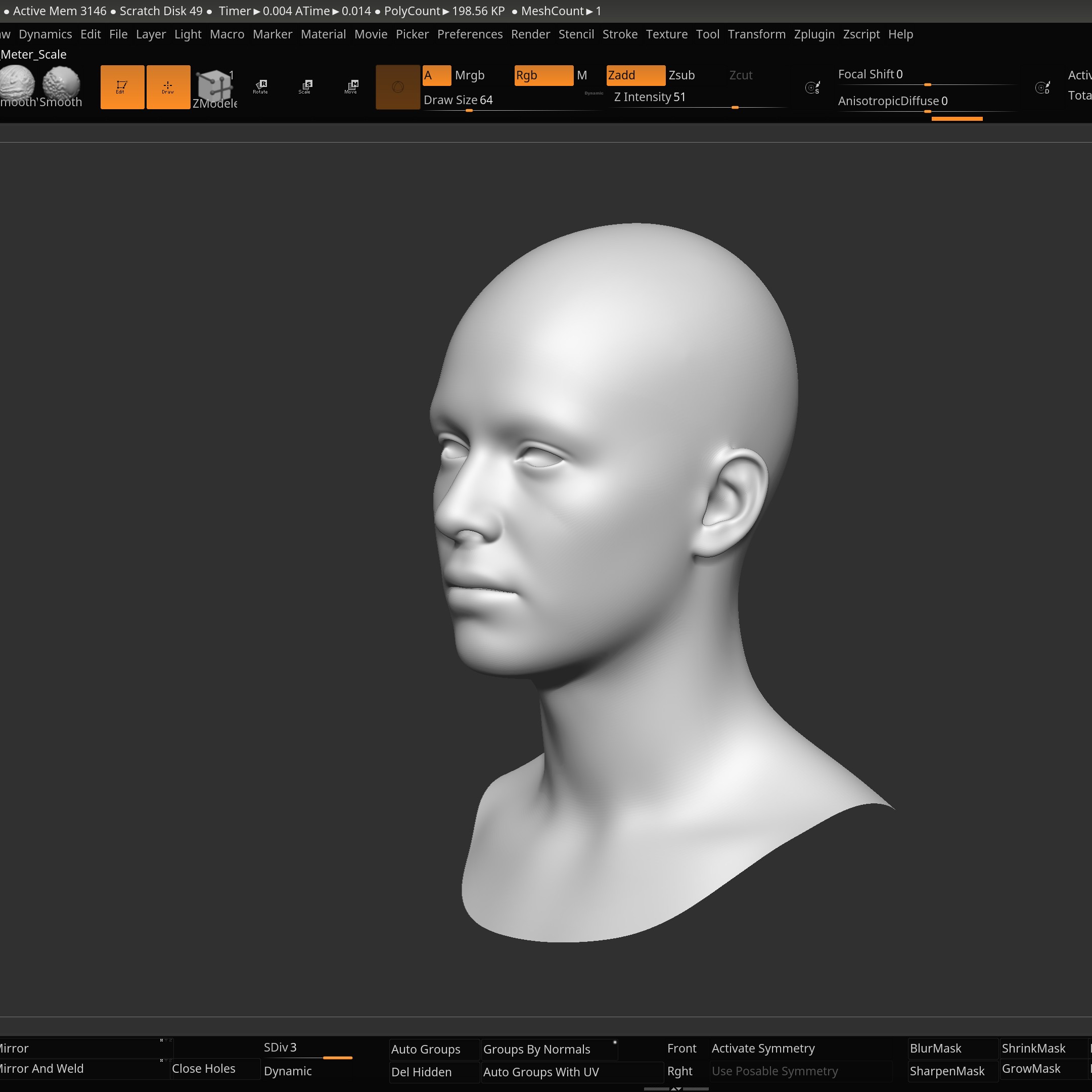

Hi, Ive noticed that subdivsion (SD) levels, and switching on/off layers can bake (probably) unwanted effects onto your mesh.
Here is a quick test:
- Have a head subtool with 3 SDs
- On a new layer, scale the mesh down
- Exit layer recording and turn off layer
Now switching on/off the layer, everything works as expected.
But instead:
- Switch on the layer
- Go to SD1
- Switch off the layer
- Go to SD3
Now the mesh has been smoothed
Repeat several times, and your head is a different person
