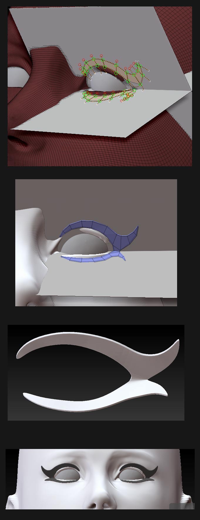

I wasn’t able to illustrate my post earlier, but some of the things I said might make more sense if you could see them:
lashtut
This is what I was talking about when I mentioned inserting some planar geometry. Just append it as a subtool, and then it will act as a platform on which to draw out your topology nice and flat. Realistic lashes would not be flat, but stylized lashes often are, and it will make shaping them easier. You can pull the points into a more curved shape after if you like.
When you draw your topology, it doesn’t have to be perfect. You will use ZModeler to edit it into shape. With the planes visible, you will be able to use the surface of the planes for snapping with the ZModeler> Point> Move function with “Snap to Surface” enabled. Move and slide the points and edges around until the geometry creates the desired shape. Pull the points down to the countour of the eye so the lashes match the curvature.
Enable Dynamic Subdivision with a degree of thickness to preview the mesh as a subdivided 3d shape. When satisfied, click “Apply” in the Dynamic Subdivision menu to apply that thickness and subdivision to the actual mesh as real geometry. Mirror and Weld to the other side.
One final tip: if you press and hold ALT after making contact with the Move Brush, it will instead push and pull a surface inwards and outwards in a normalized direction, rather than sliding it around the screen plane. This can be useful for bringing forward a section of mesh that has fallen below a target surface and can’t be easily seen.
