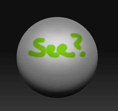

  • I polypaint the word “See?” on the sphere
  • I press COL>TEX

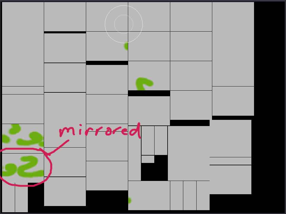

  • The polypainting is copied to a texture, but if I use Fill Layer to examine it, the writing is mirror-backwards and says: “?eeS” (with each letter backwards as well)
This isn’t something I can just flip in photoshop because the UVs caused the texture to be split into various odd pieces, with each piece having part of the reversed word. If I flip the whole texture, the pieces aren’t in the right spots anymore. I took some screenshots and attached them here:

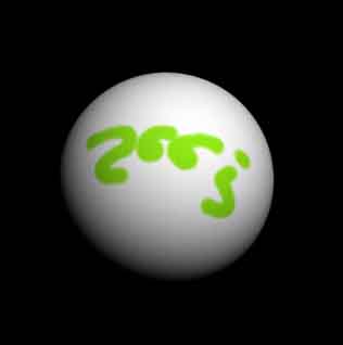

Thanks aurick. Yes, actually I am having trouble with the finished model (in 3DS Max) – should have mentioned that in my first post.
I have tried every combination of flipping the texture in photoshop and using the U and V tiling setting in 3DS Max, and the end result is always the same: either the texture is mapped incorrectly and looks like several disjointed pieces tacked on (UVs don’t match up) or it looks smooth and perfect…but mirrored, like this screenshot.
It must be an issue with how the UVs are exported, because the model looks right in ZBrush. I have tried exporting with and without the “Flip” option, but it doesn’t seem to make a difference either way…
