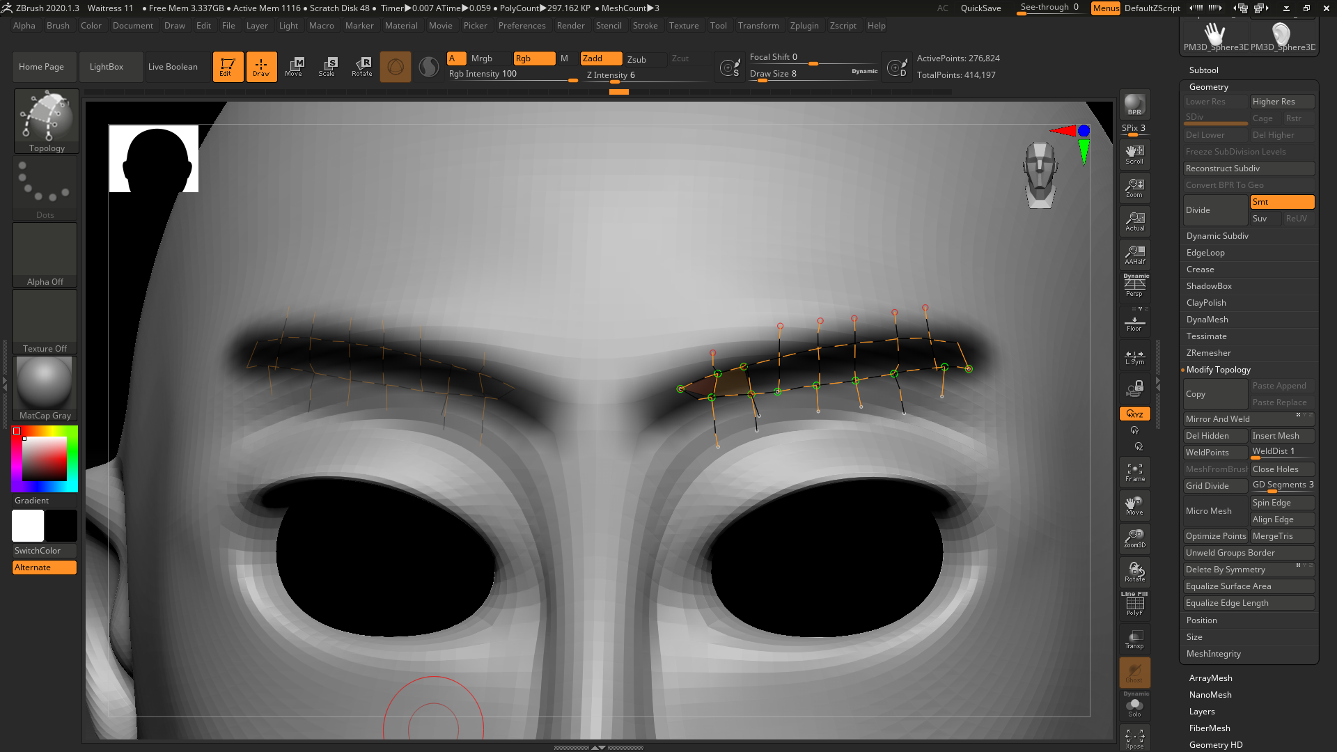

Hi there
I am currently using the topology brush to make some eyebrows but i cant seem to get the brush to work properly and make polygons and i get empty spaces sometimes.
any advice would be greatly appreciated
Hi there
never mind i think i needed to change brush size.
does the draw size affect the brush?
It can sometimes be difficult to tell what’s happening. Concentrate on establishing the intersections. From one viewing angle it might appear as if two lines are intersecting, but they may in fact be overlapping due to irregularities in the surface or the way that they’ve been drawn.
You can tell your vertical lines arent intersecting with the top horizontal line, because there are no green circles there. Since there is no intersection, there will be no polygons. Polygons will only be drawn if there are 3 or 4 points are connected.
It will affect the step spacing in the line being drawn, and the thickness of the resulting geometry.
This video may be useful:
i see thank you very much
cool thanks again
