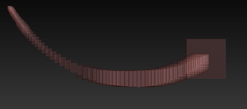

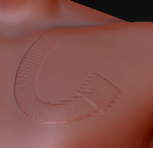

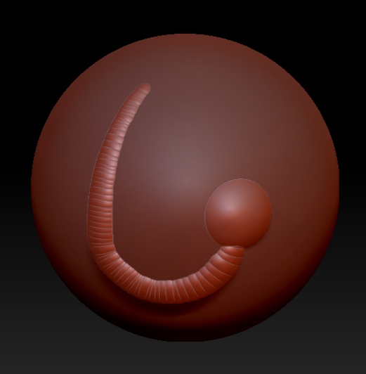

I’m having a very annoying problem when using my pen tablet. It seems that most of the times when I make a stroke at the end of it the size goes way to high.
It happens with everything normal strokes, zsketch, modeling brushes etc.
I’ve tested my tablet with other applications and it works just fine, I also tried to adjust the tablet preferences, so far… nothing.
Maybe I’m doing something wrong, honestly I don’t Know, I’m a beginner with zbrush.
Any thoughts on this one?

I had the same thing happening and tracked it down to how I lift the pen when finishing a stroke.
Not sure if I just adjusted how I lift the pen at the end of the stroke or if i adjusted the tablet prefs. I see you adjusted your prefs… did you try in both the system prefs and zbrush prefs or only one?

In brush palette there is a subpanel for Tablet pressure…

Thanks a lot! I tweaked the pen settings, both ZBrush and System, and managed to reduce this strange behavior.
Thanks again
