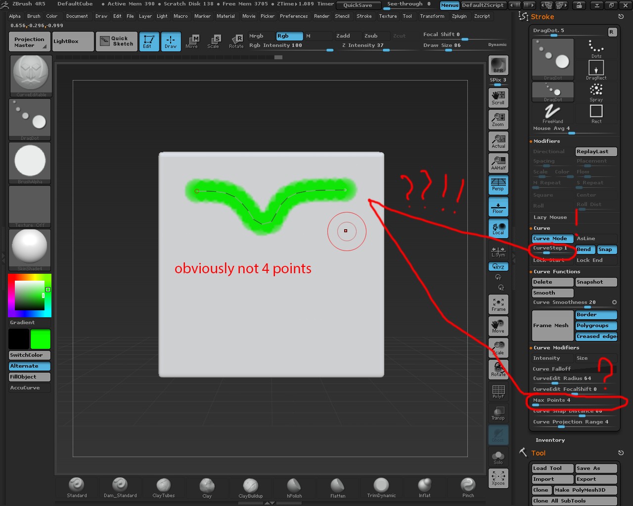

Max Points simply do not work! [time on video 45:10]

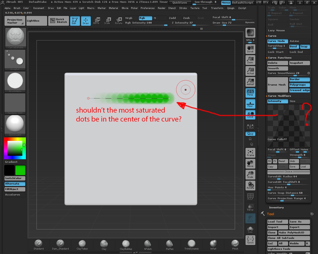

Curve Falloff strange behavior with Curve Editable brush (and with others) [time on video 43:18]

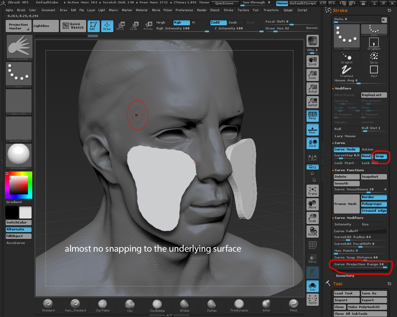

Curve TriFill and QuadFill brushes do not snap to surface when Snap button is on. Only the first dot snaps, but the rest of the curve is parallel to canvas (regardless of the brush size). In Paul’s example it did snap [time on the video 39:20]
