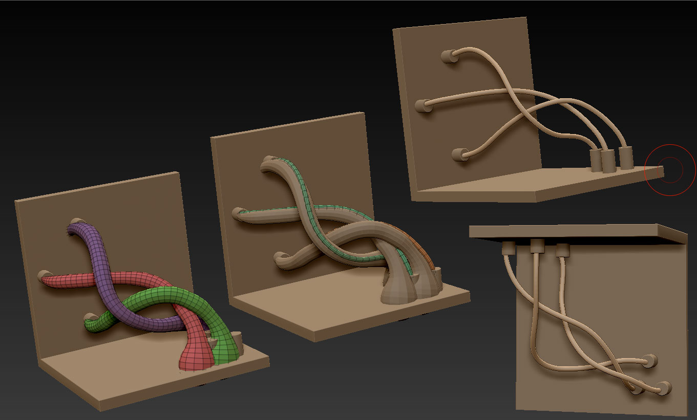

Not sure if you’re interested in tips, but the trick, I find, when trying to make a complicated tube that bends along multiple axes in 3d space, is to sculpt a quick guide object first.
It doesn’t have to be pretty, so just snakehook out a blob of clay with dynamesh or sculptris mode. All it has to do is establish the general curvature you want for your wire. Much easier to sculpt that curve when you dont have to worry about form, than to wrestle with the dragging and pulling stroke curves in open air. I agree that the curve stroke adjustment functions are mostly unusable for anything other than a tube that only bends on a 2d plane.
Once your rough guide object is established, THEN use the curve tube snap brush to draw out a curve with uniform proportions along that object, and delete the guide object.

The Curve Tube Snap brush is specifically designed to draw curves along a guide object. It is working as intended, and is the best way to approach drawing complex curves, rather than editing a spline in mid air. I did however omit a lot of information that makes this easier to do, so even if you are not interested, I will post this here for anyone else who is interested in the topic:
  1. Obviously, you need to be comfortable grouping, masking, and hiding polygons at will in Zbrush. If these functions aren’t as natural as breathing for someone, they will likely struggle with a great many things in ZB. Likewise, if someone is not comfortable sculpting in zb (snakehook, smooth, inflate, move, etc) then sculpting guide objects wont feel very simple to you.
  2. When drawing curves, increase the Stroke >Curve > Curve Step slider value as high as possible, to keep the curve as smooth and simple as possible. When sculpting guide object, remesh frequently to keep the polycount low, and consider giving them a quick Zremesh at the end to reduce surface complexity.
  3. Turn on ghost mode when drawing the curves to ghost all subtools save for the guides–this allows you to conform the curve to the guide objects and nothing else, while still seeing where everything is.
I did this about as quickly as I could edit a spline someplace else and mess around with import/export–it took me longer to write this actual post:
Some people are more comfortable in certain types of toolsets, and prefer the precision of working with more mathematical, mechanical tools. I prefer approaches like this, because it keeps me in the ZB mindset–a sculpting mindset.

I have no idea why you’re shitting on what I just did. How precise do you need them to be? I exerted like zero effort in less time than it took to write the post, and easily got them to line up with plugs on opposite sides of the object, with complicated intertwining along multiple axes, and I did it with intuitive sculpting and brush strokes, rather than artificial ropes and pulleys and complicated gizmos.
Want them to be even smoother? Use fewer steps in the curve. Want them to be dead center in the plugs, which I didn’t care about? take a second and nudge them into place–as long as you keep them low poly, minor corrections wont deform the tube.
Again, not arguing that the curve edit controls aren’t bad–I personally think they’re mostly garbage and avoid them altogether. They could definitely benefit from improvement, although they wouldn’t crack my top 50 on a priority list. Just pointing out that simple wires are easy as long as you’re using Zbrush to its strengths (sculpting and hand-worked form), instead of expecting it to perform like a traditional polygonal modeler. We use ZB precisely because it doesn’t perform like one of those, and can do things that those programs cant. Stop fixating on what other programs do (because they cant do it any other way), and start thinking with the tools at hand.

@spyndel thanks, I was looking for some way like this :stuck_out_tongue:
