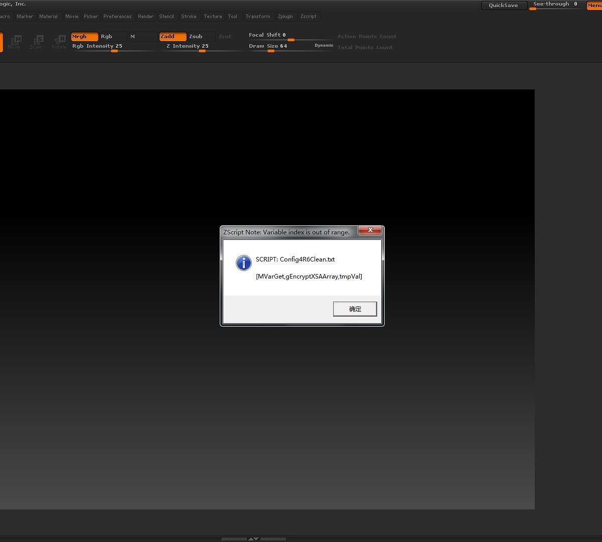

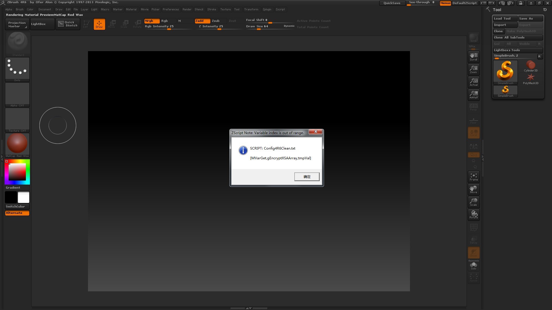

Install done***65292;but when i use the zbrush4r6……Got a problrm***65281;I Can’t launch ZBrush.help me please***65281;thank you***65281;
My first recommendation would be to update to the P2 patch. That had a number of bug fixes. In your ZBrush folder, run the ZUpgrader application.
