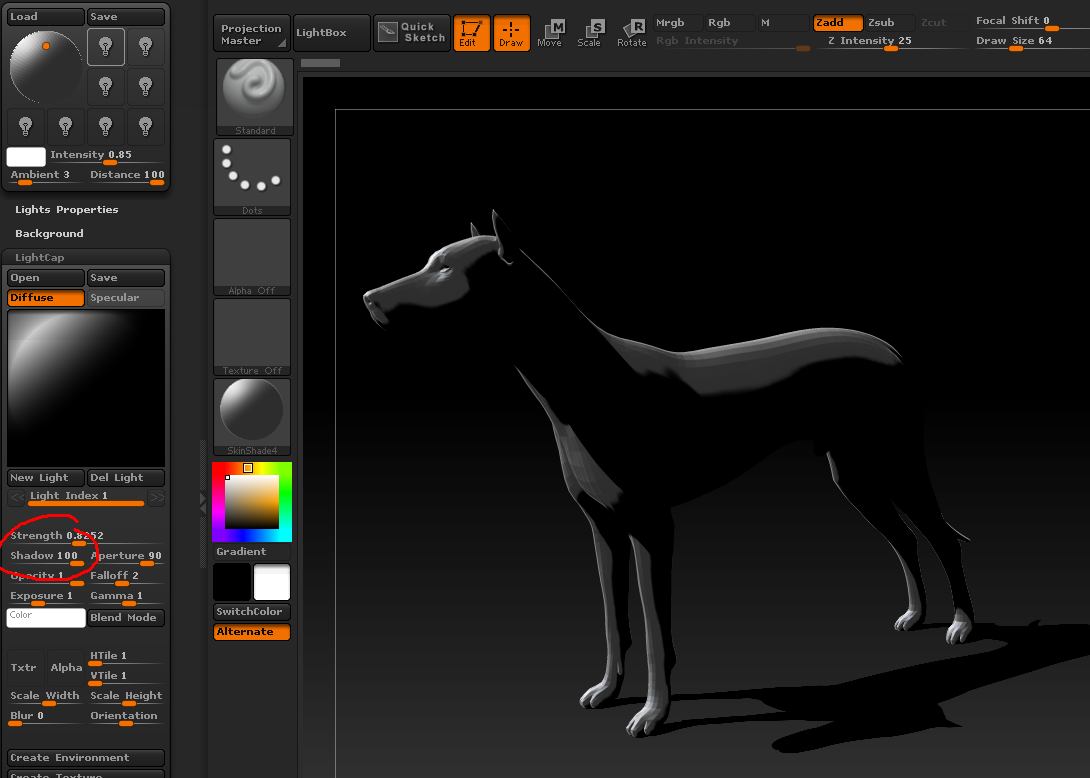

Make sure that the LightCap>Shadow slider is not set to zero. Also make sure the grid is showing before you do the BPR render. The shadow will only show after a BPR render.

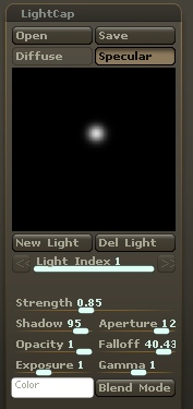

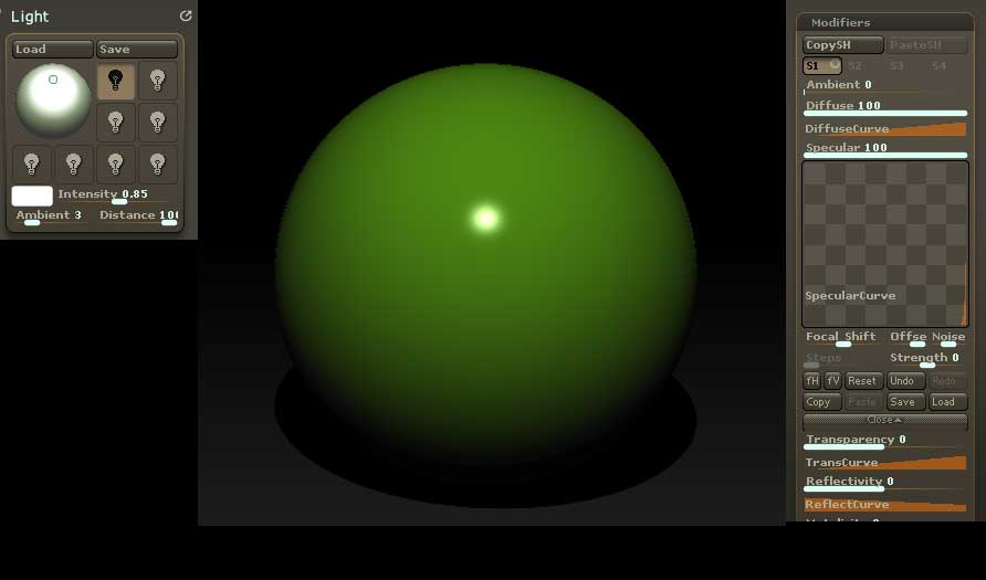

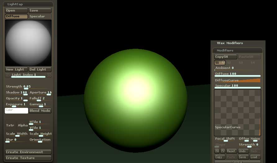

I noticed difference between standard Light (SL) and LightCap (LC) when I want to make a thin specular on the subtool - the preferences are similar, but LC do not give such effect (thin light) as SL:
LightCap:
Standard Light:

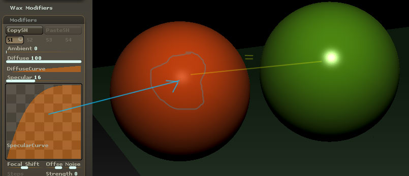

I try to configure “specular” in the LC preferences - yes, it is works, but for ALL subtools.
In the material menu I could influence only on the specular intensetive, but the size of it is the same on the both subtools (cause of LC specular).
LightCap and standard lights work in different ways. You will have to experiment to get the results you need.
