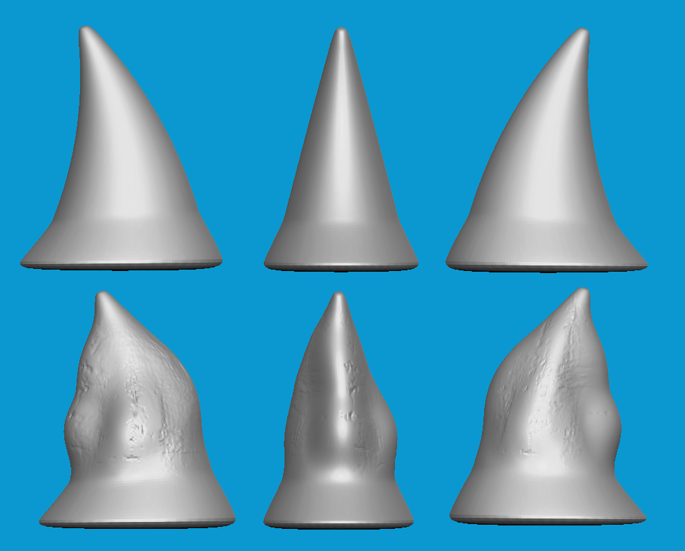

So I’m modeling a tooth and I want to project “fossil” detail using spotlight. I want the tooth to stay the shape I modeled it and just get the cracks and crevices in the photo on to the tooth. If I am using the standard brush it deforms the shape of my tooth. If I use any other brush including the layer brush it also deforms my original mesh with the projection.
The top row is my tooth. I want to end with this shape and just get nicks and cracks from my photo onto this mesh.
The bottom row shoes what happens after using spotlight with the standard brush. It deforms my mesh while projecting those details i need. How do I stop the deformation while getting the cracks and crevices to project onto the surface?

Yes, I understand that the standard brush has too powerful an effect for your needs. The Layer brush set to a low z intensity should not do this. Are you saying you still get a similar problem with the Layer brush?
You can also store a morph target with the layer brush, and it will only displace to a consistent amount from the surface of the MT, so the displacement would be completely uniform.
It’s also important to keep the nature of the image you’re displacing with in mind. A simpler white cracks on black image set to Zsub may work better than an image with a lot of shades of grey for your purposes.
