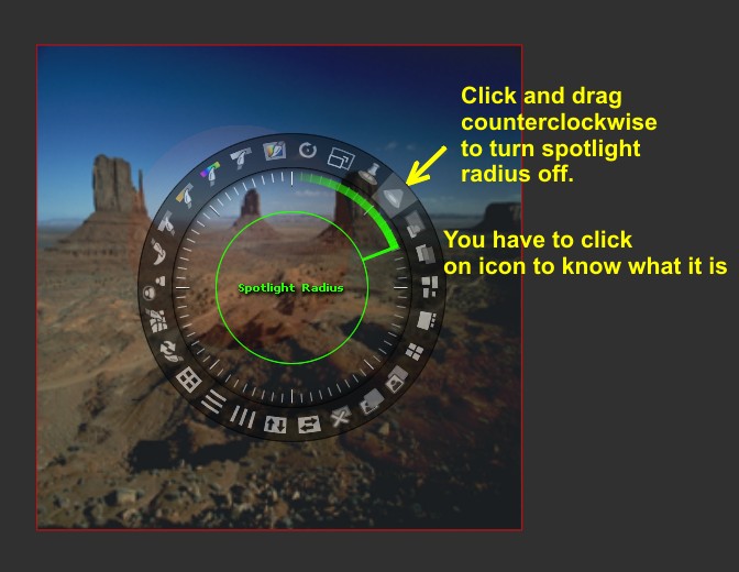

I need a little help with my spotlight issues.
When I have images in spotlight loaded an then press Z to get out of the dial all my pictures ‘disappear’ Just when I mouse over that area where the pictures would be I can see some portion of the picture(s) depending of my brushsize.
What and how did I do this? :rolleyes: …and how can I get back to original setup?
Second question. When there is the spotlight dial visible the Information of the icons only is beeing displayed when I click on it. Is there a way that the information of the Icon is displayed just when mousing over ?
Help appreciated
Thanks in advance
regards
Alex
You turned it on by increasing the spotlight radius. If you don’t want to use the spot, then turn spotlight radius back to 0.
There was my mistake.
Thank you for help
