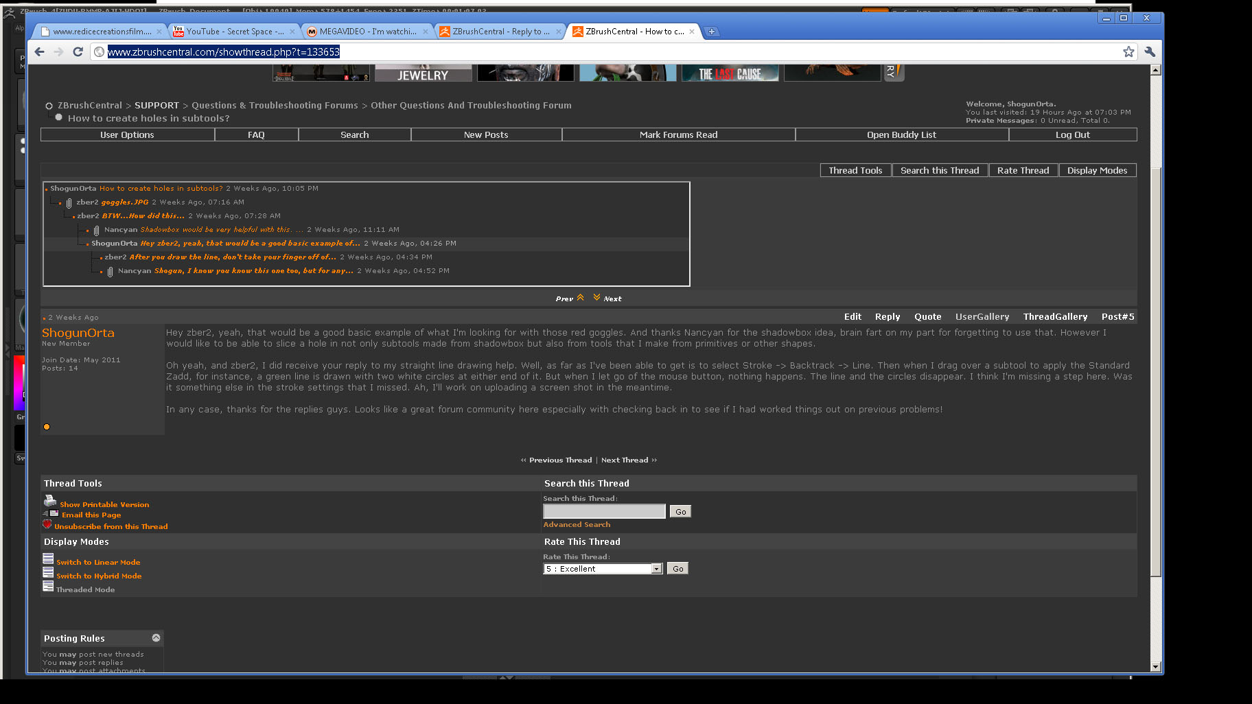

Here’s a link to the post: http://www.zbrushcentral.com/showthread.php?t=133653
And also attached is a screen print.
I’m sorry if I inadvertently caused some strife on here. I know people get kicked off forums. And no I don’t think I’m sucking up by writing all this, but only inviting the senior staff to look at what has been said and then infer that there has indeed been a mix up here. And for the record, thank you again Nancyan for your help with the Split Hidden tool question. As for zber2, I’m trying to mend the fence here, I understand your point but if you’re going to get bent out of shape over unwitting circumstances beyond me and yourself, then perhaps this forum isn’t the place for me. Nevertheless, I extend the hand of friendship no matter if it gets cut off and endure with more patience than I was granted. So for your past help up till now, thanks-ish again but I don’t like people either who don’t show any consideration for others unknown circumstances. In effect, there was a better way to present your grievance rather than calling me an ingrate.
