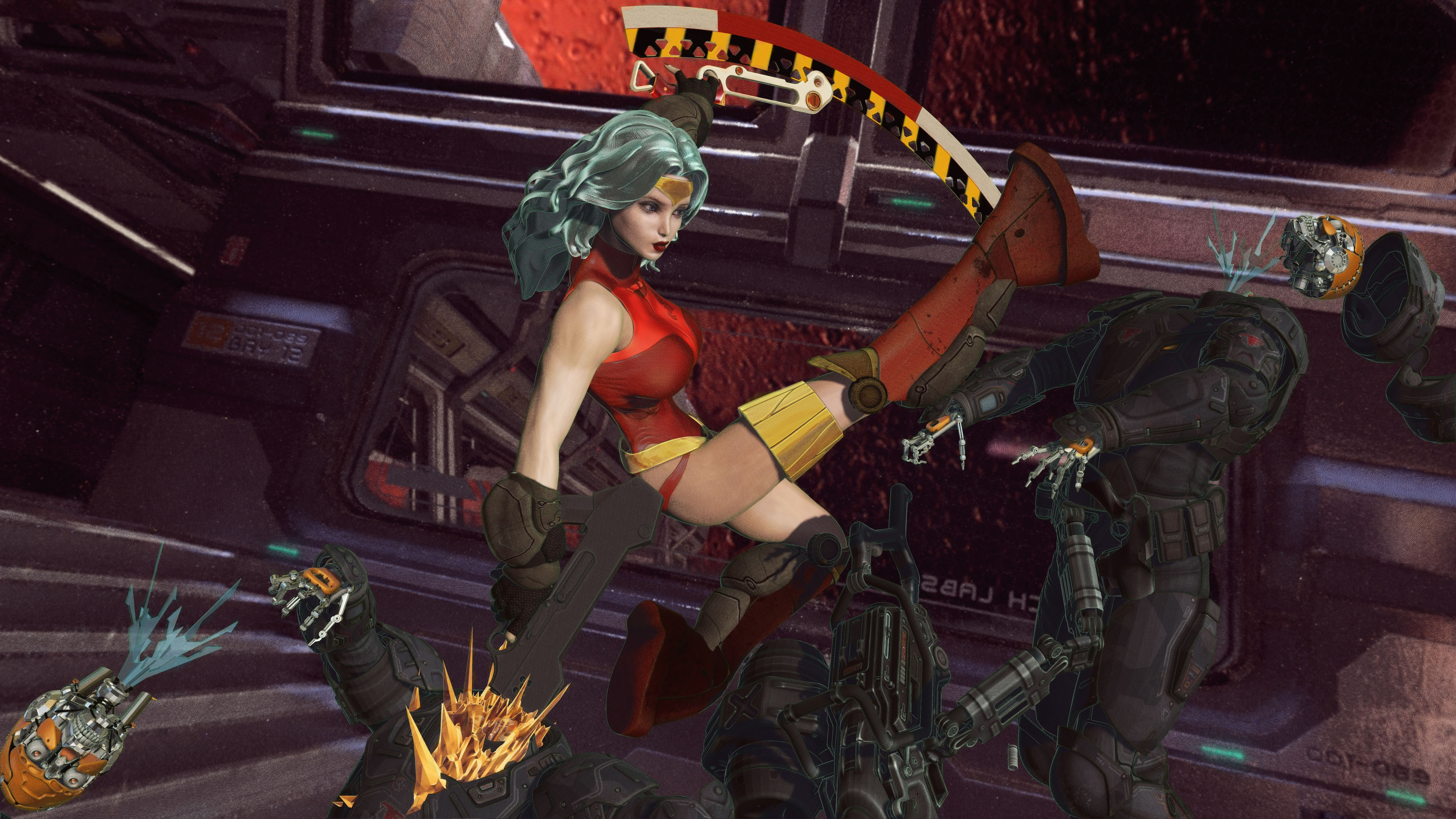

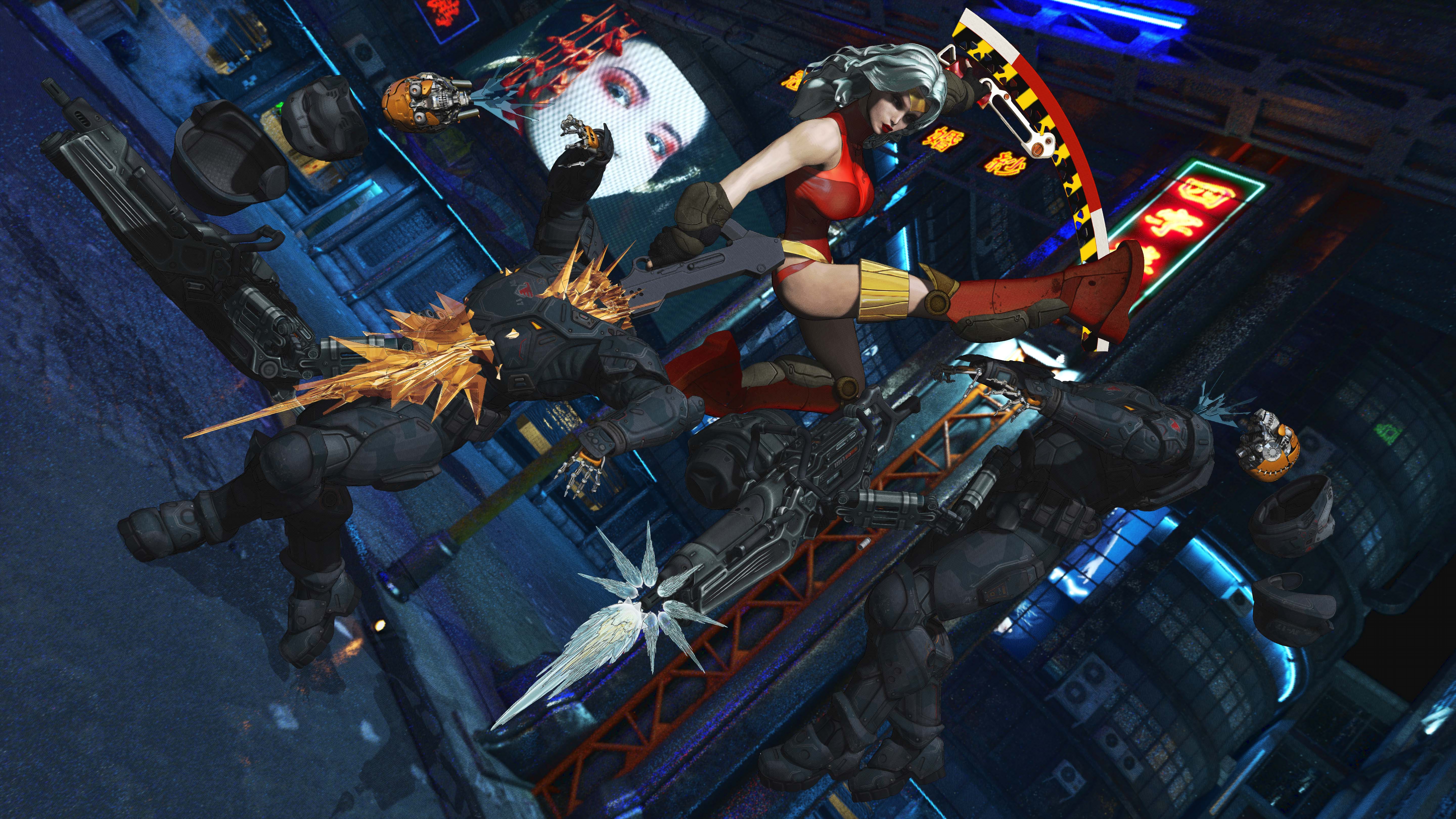

The background is a DAZ Studio IRAY spherical render of Stonemason’s Sci-Fi Corridor 2013.

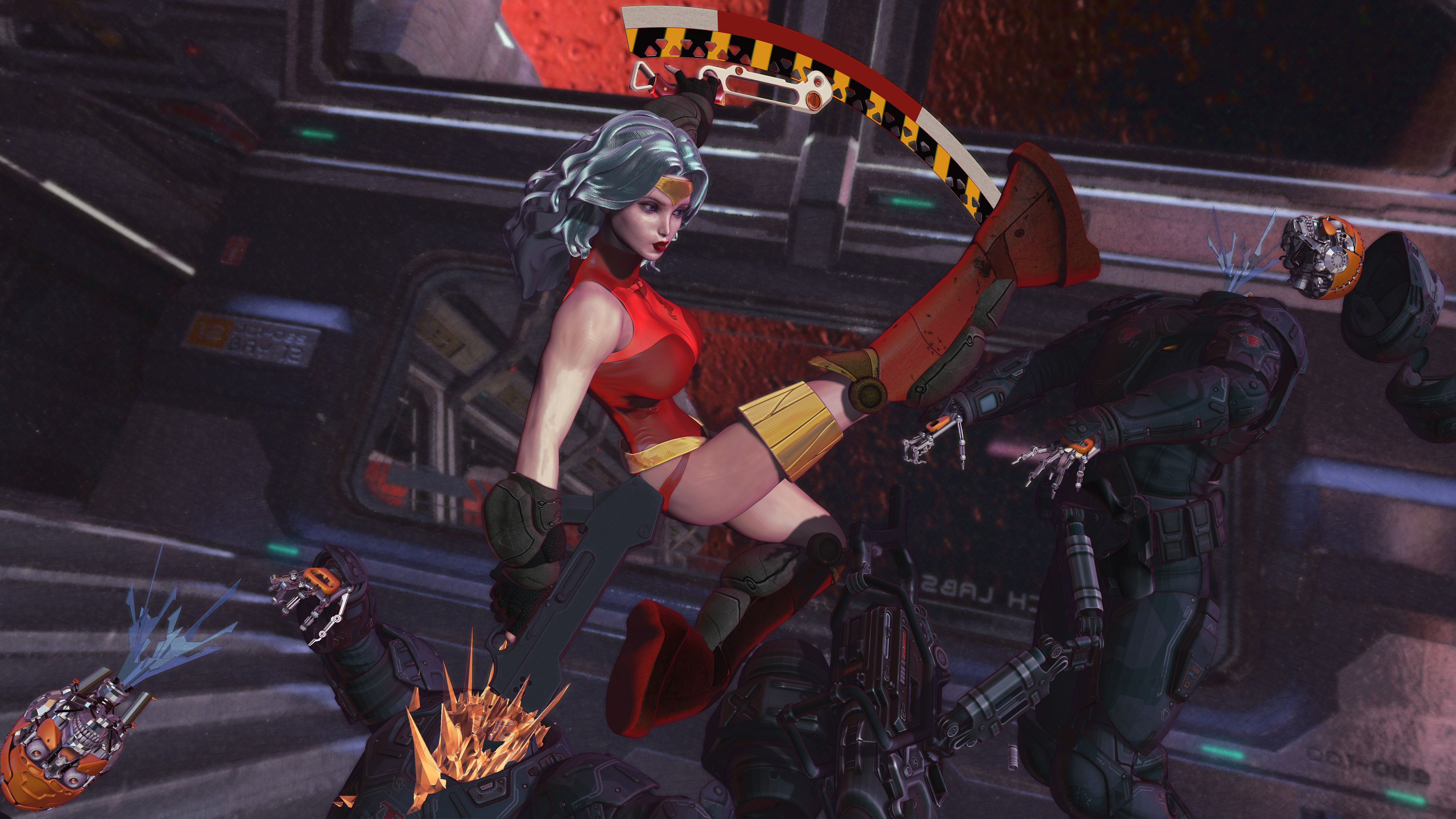

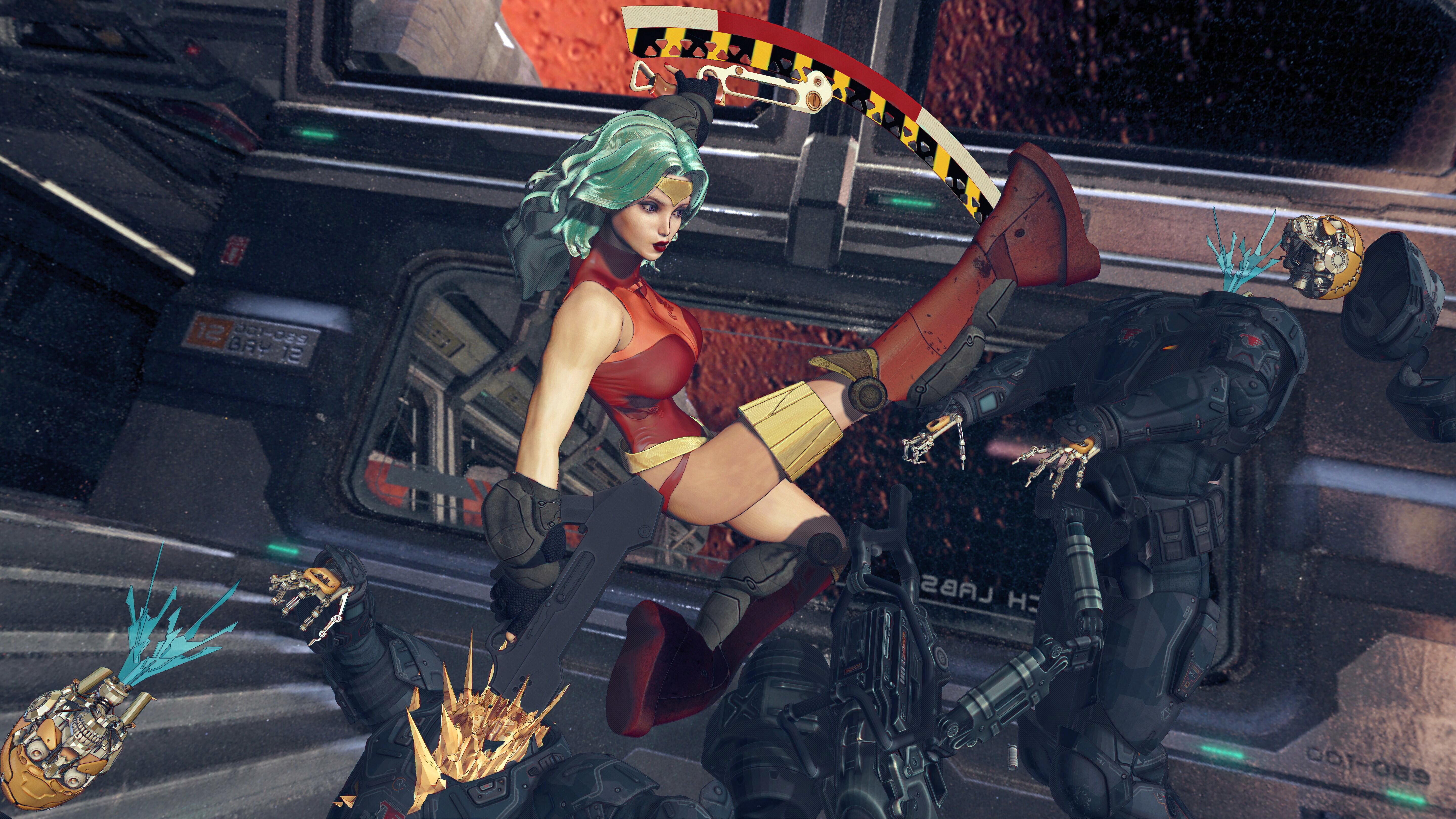

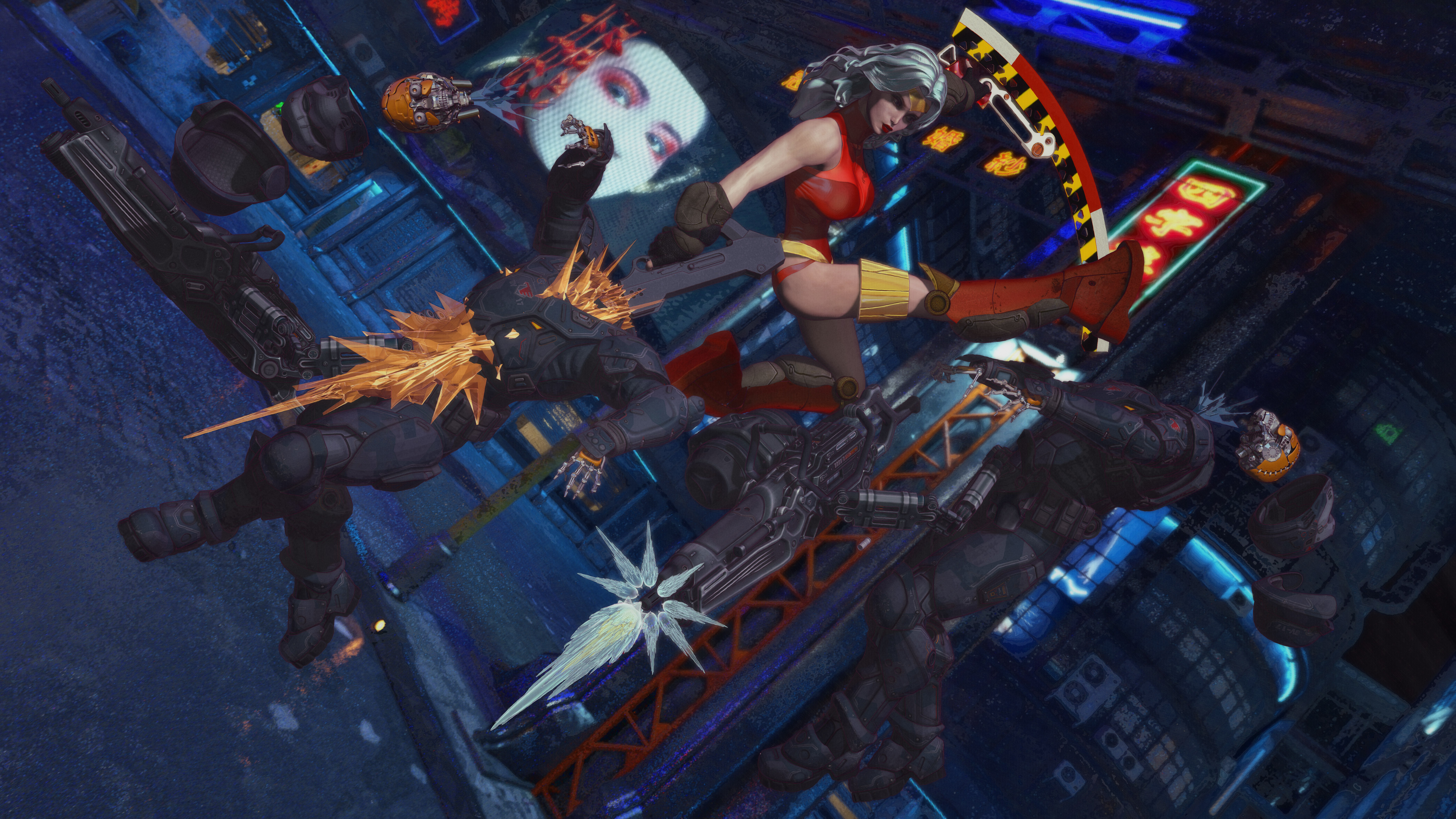

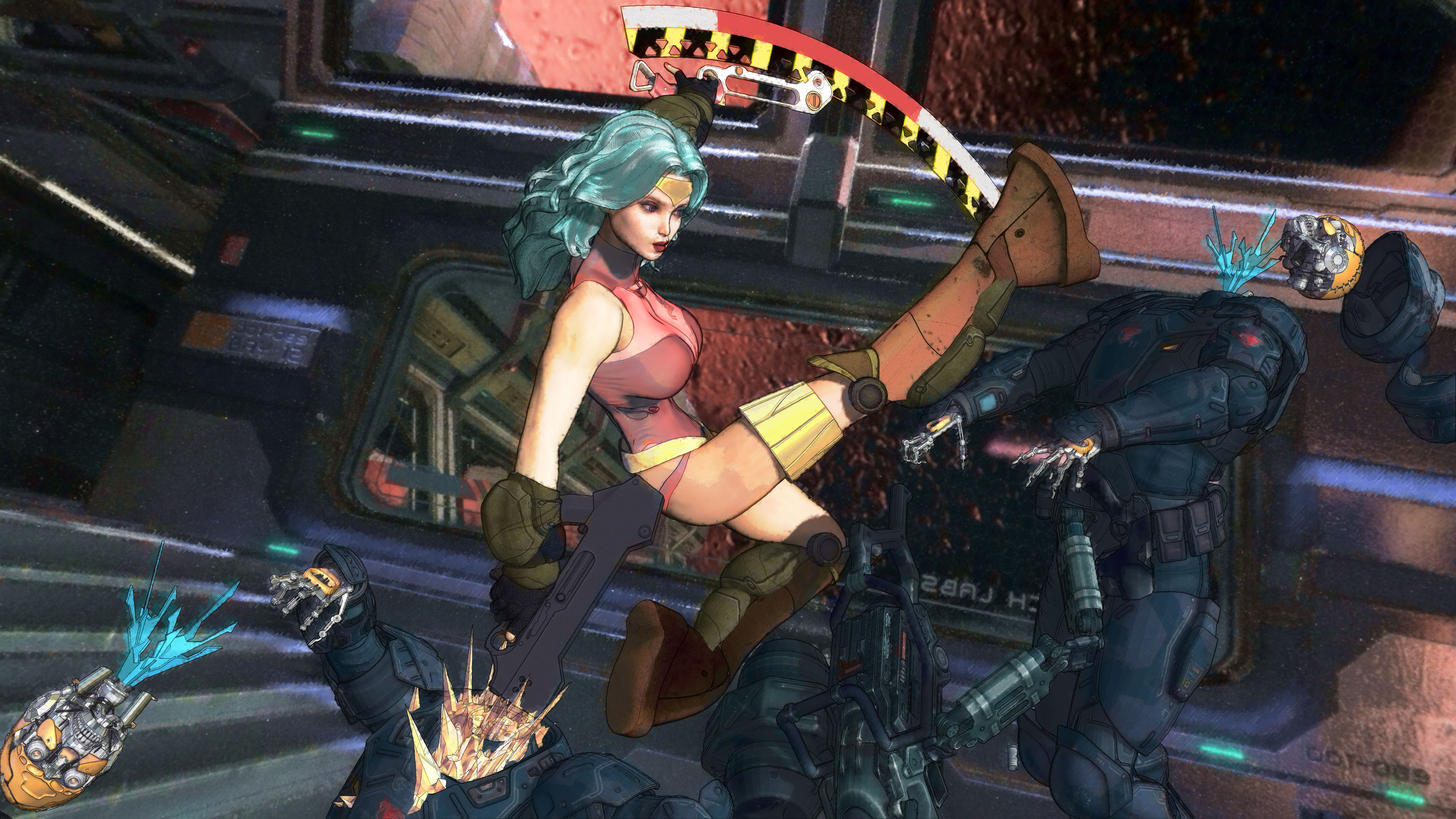

This is a composite of Daniel_Bel_Comix, Chromatic_Aberration, and a Pencil_Sketch_Color NPRs:

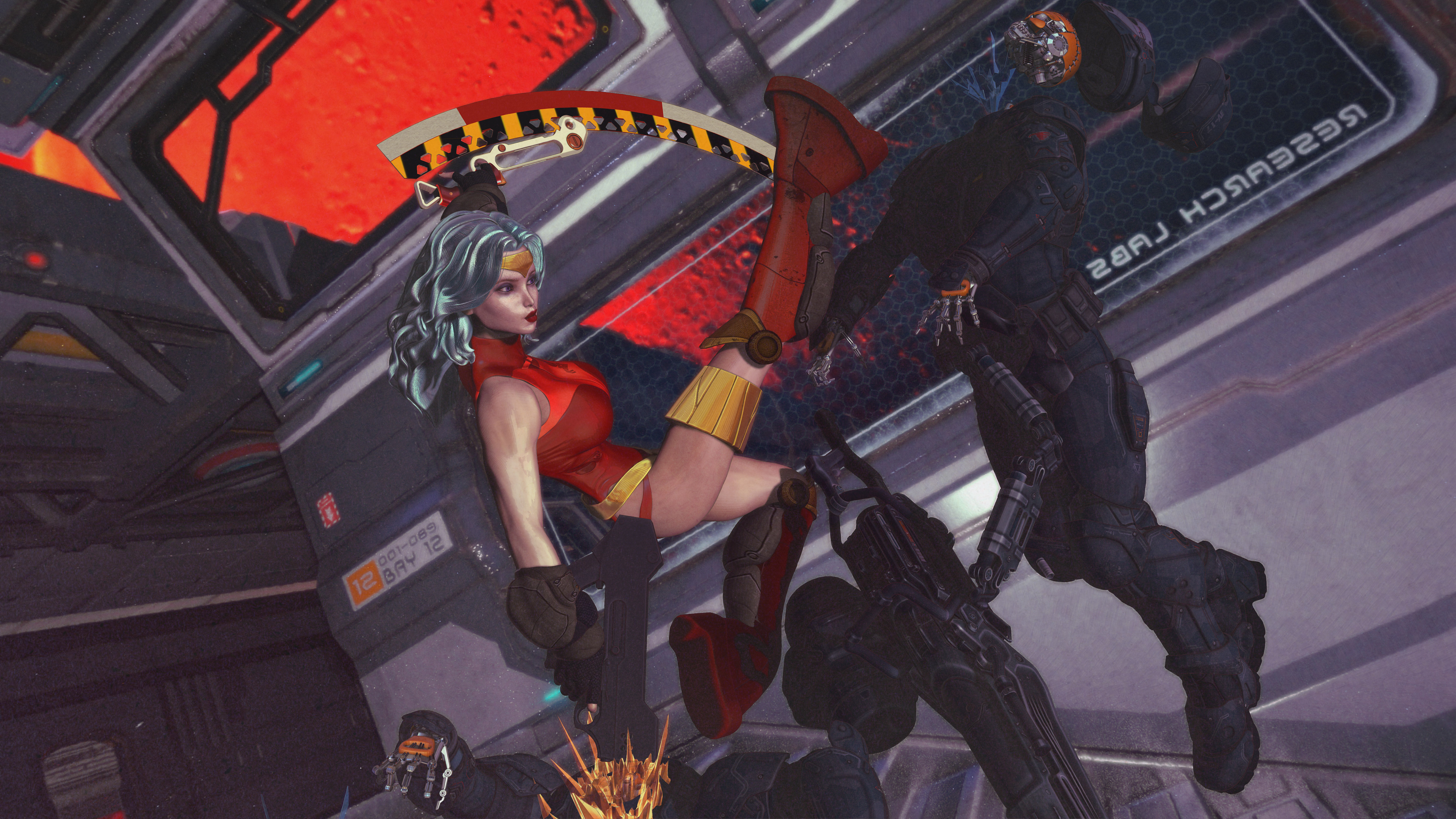

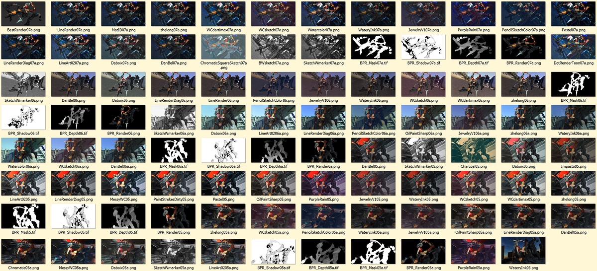

This is all of the renders these were composited from (the first six composites in this thread are the 5a shots):
The remainder of these are limited to two NPR elements only - any more than 2 - 3 images in a composite is something that I, at least, can’t keep from turning muddled and dull.
This is Line Art 02 and Watery Ink NPRs. I modified the LinaArt02 filter with a scaled up Zhelong Ink filter masked for the background only:

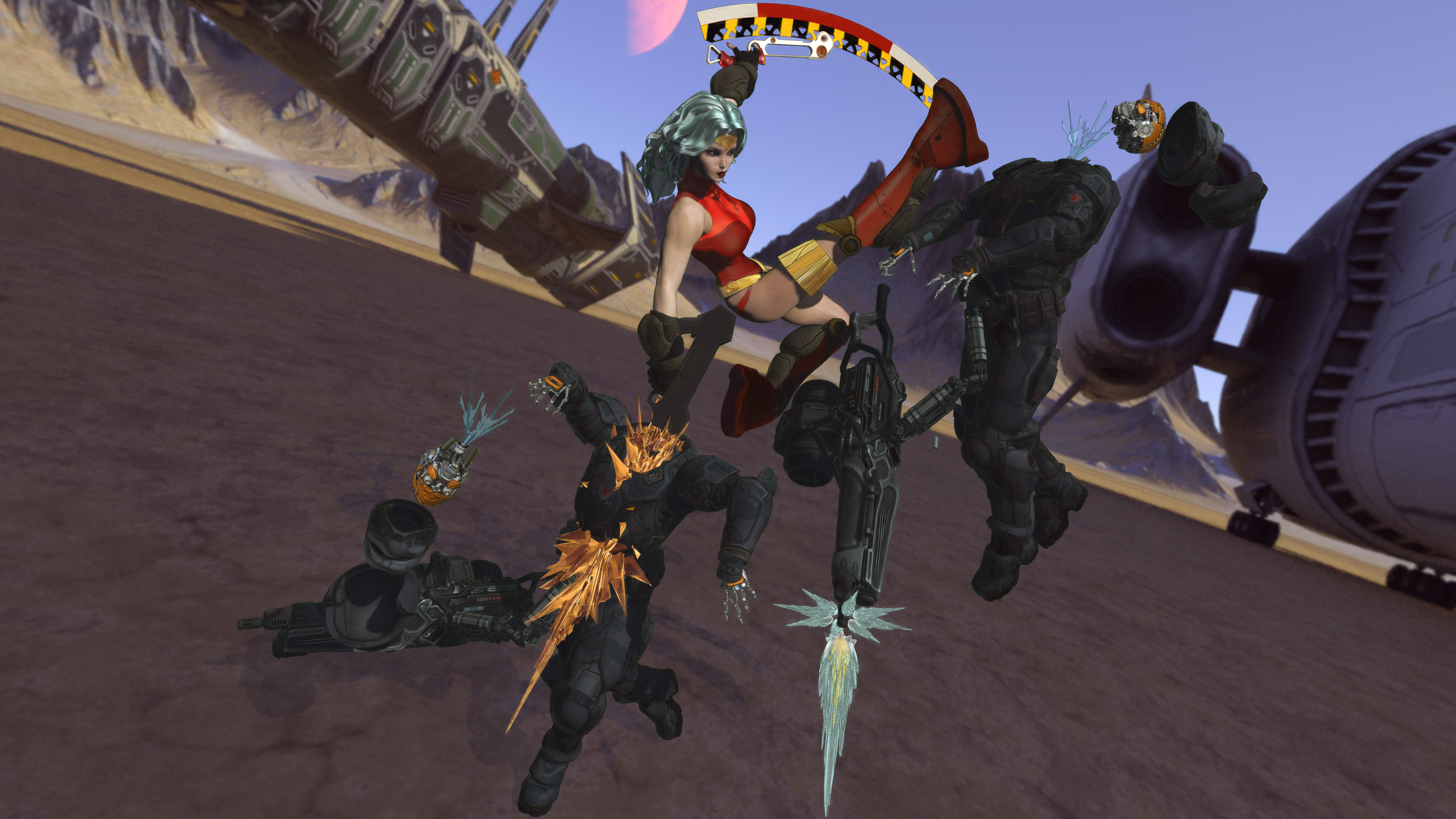

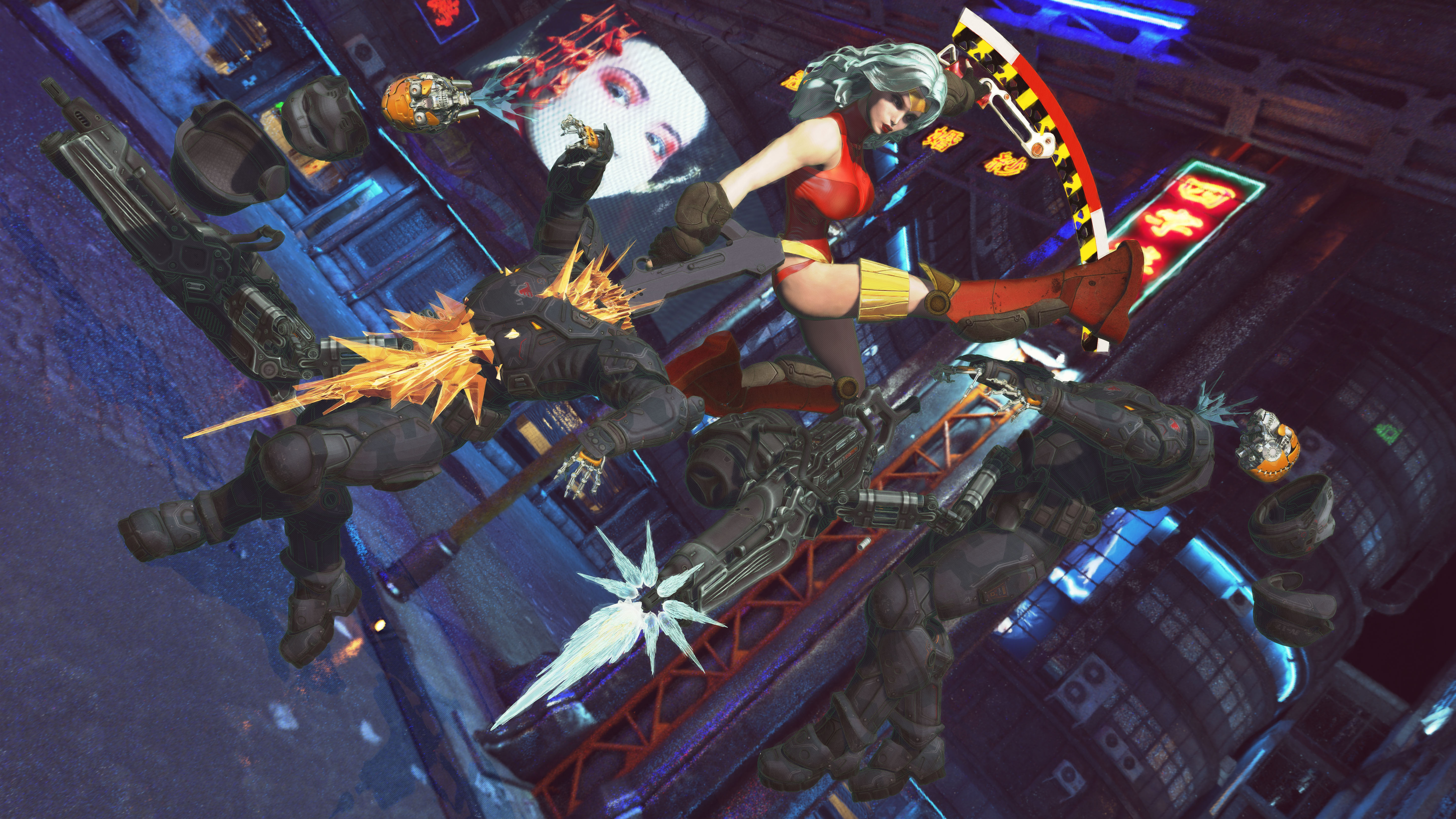

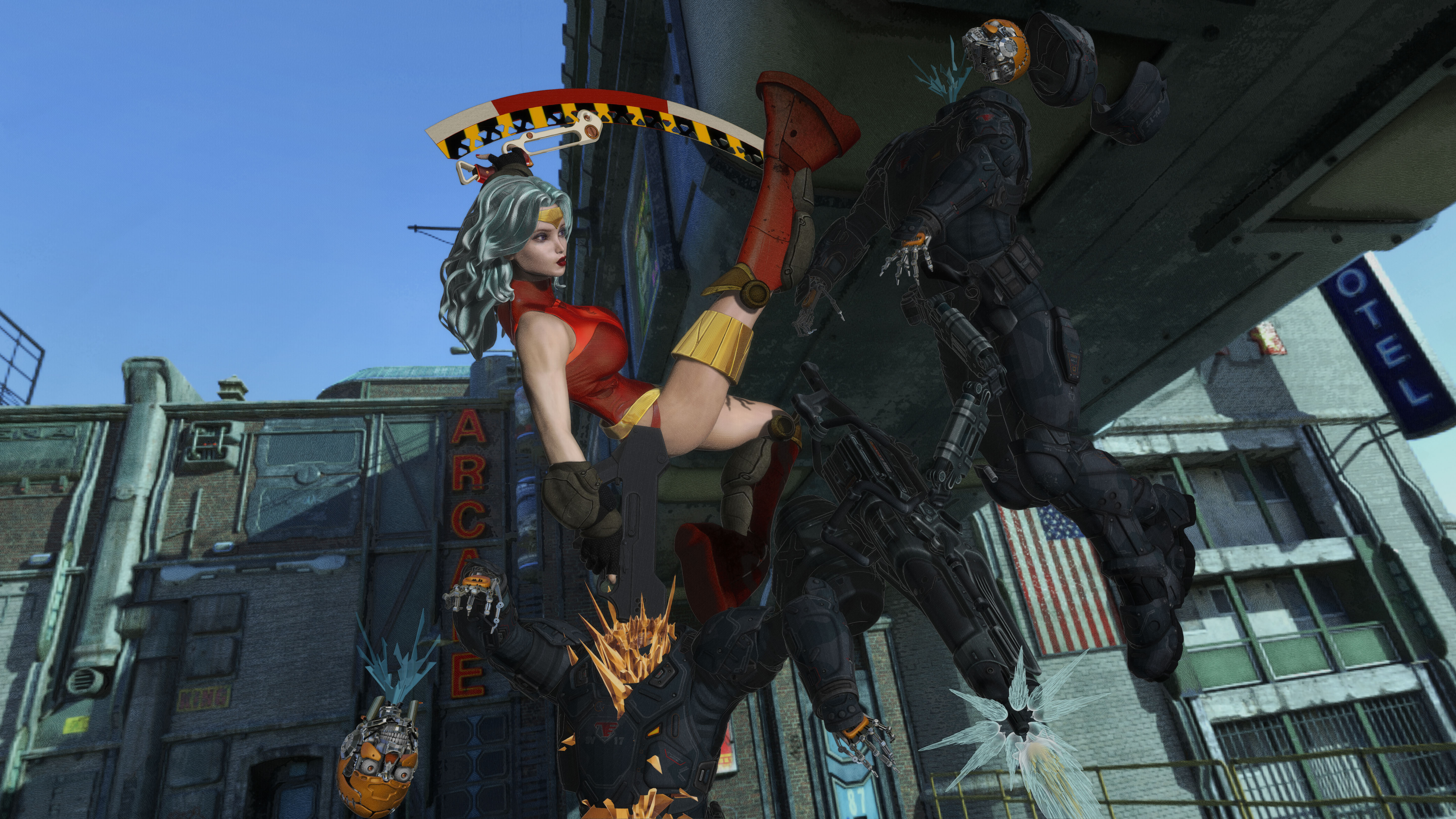

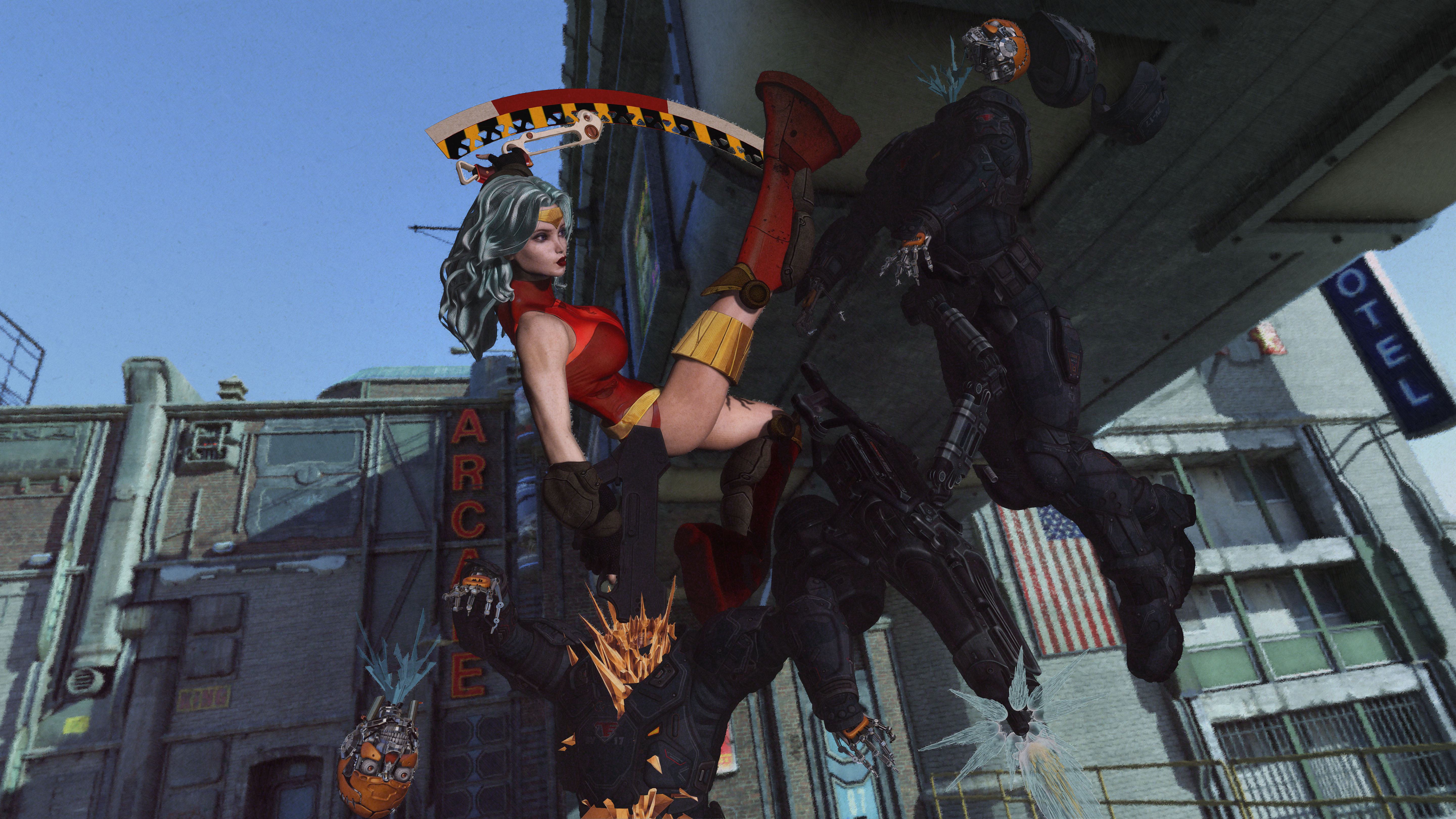

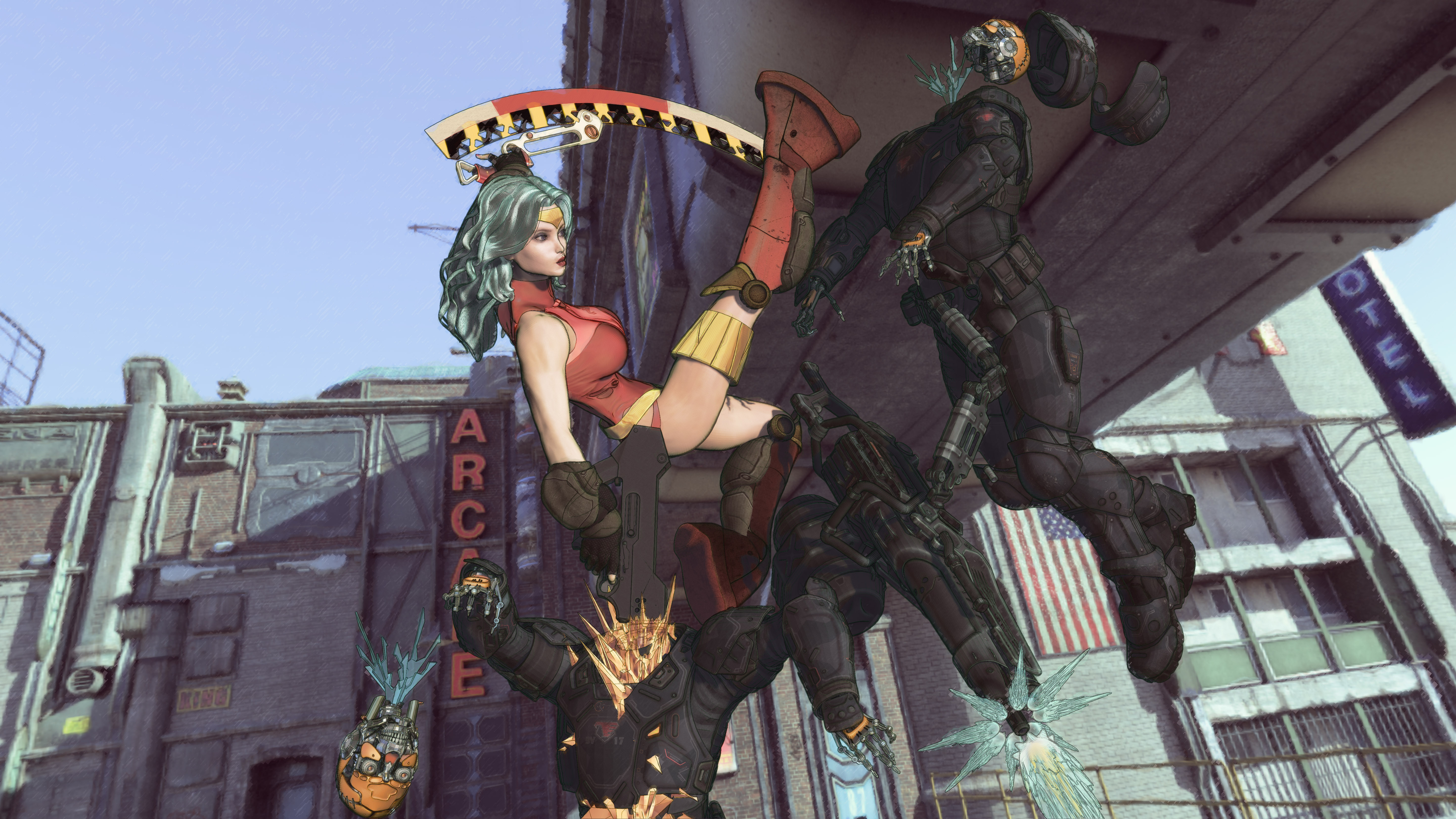

The same models with Stonemason’s Urban Future 5 spherical render background (render 07a):
Zhelong Ink & Dot Render Toon NPRs:
Purple Rain & Watery Ink NPRs:
Line Render Diagonal & Watercolor Sketch NPRs:
Watercolor Sketch and Line render Diagonal NPRs composite over 2 Sketchfab spaceships on Planet X-2 environment from DAZ:
Stonemason’s Urban Future 2 is the spherical background render here.

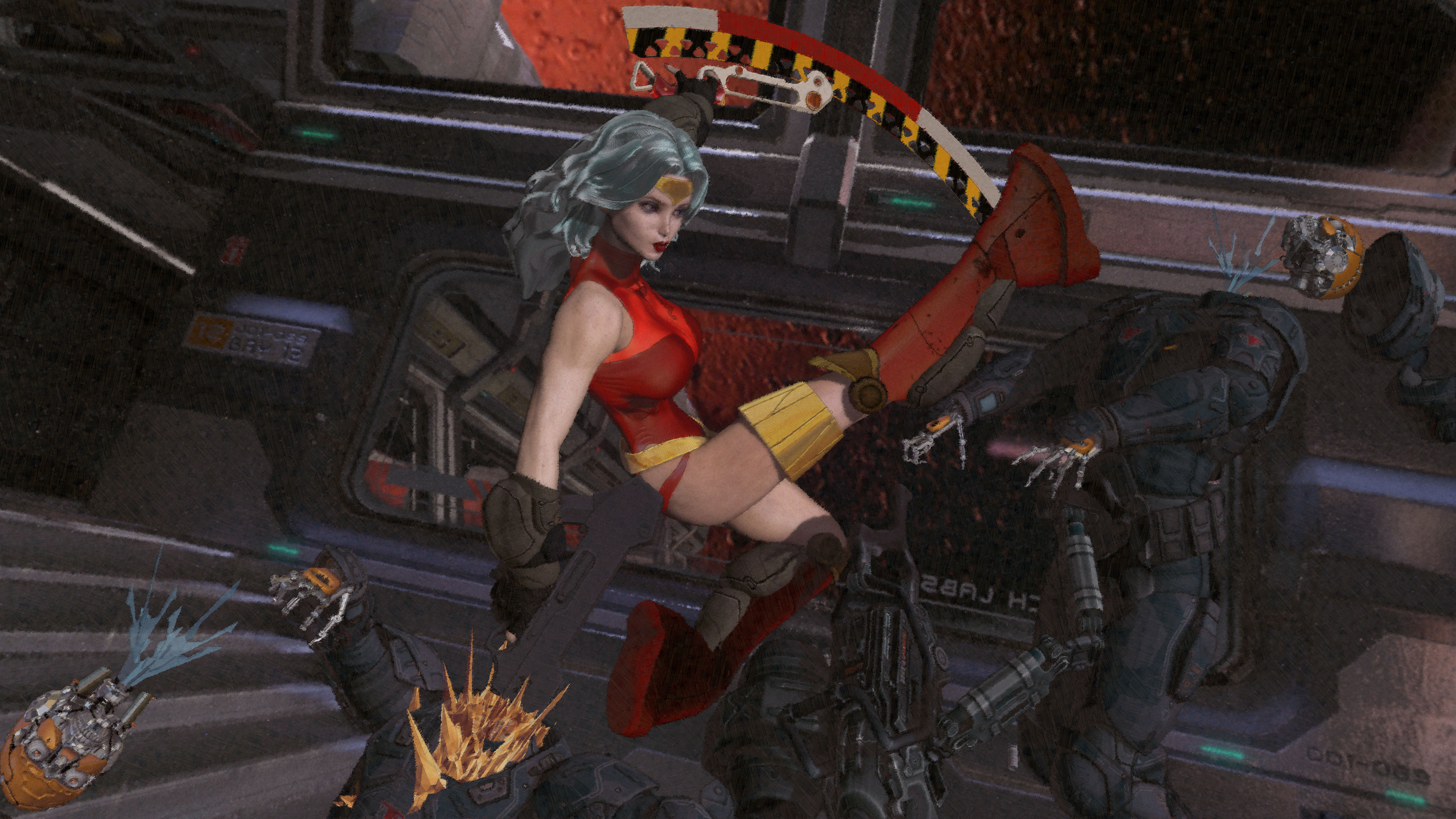

Stonemason’s Sci Fi Corridor 2013 with alternate camera and lightning.
