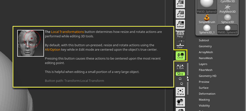

You also have Local Transformations.
Would having Local Transformations enabled help with the symmetry breaking while still in the zSphere stage?
No, it won’t help or hinder.
