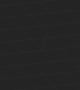

While I’m here, would you/anyone happen to know how to:
Turn OFF this grey line?
  • How to make the XYZ axis display on the Grid (floor) bigger/more visible?
Thanks
can’t turn off gray line…unless you make your document smaller than your UI. It is a safe zone for navigation when zoomed in.
draw.modifiers.frame opacity.
you can also change the fill mode up a bit so it shows up green as well.
