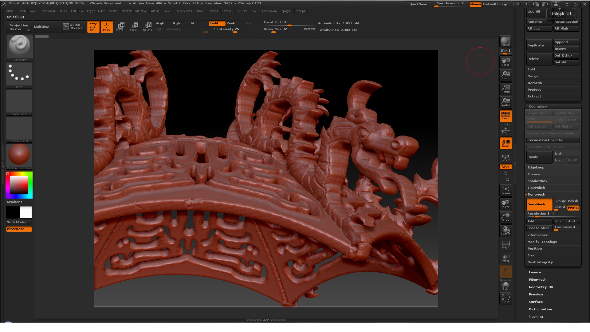

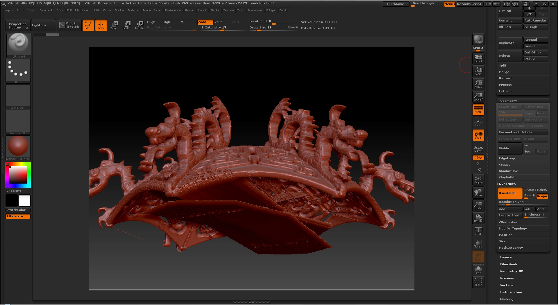

My problem is that when I Dynamesh them, the result has some stretched polys (I’ve included before and after pictures).

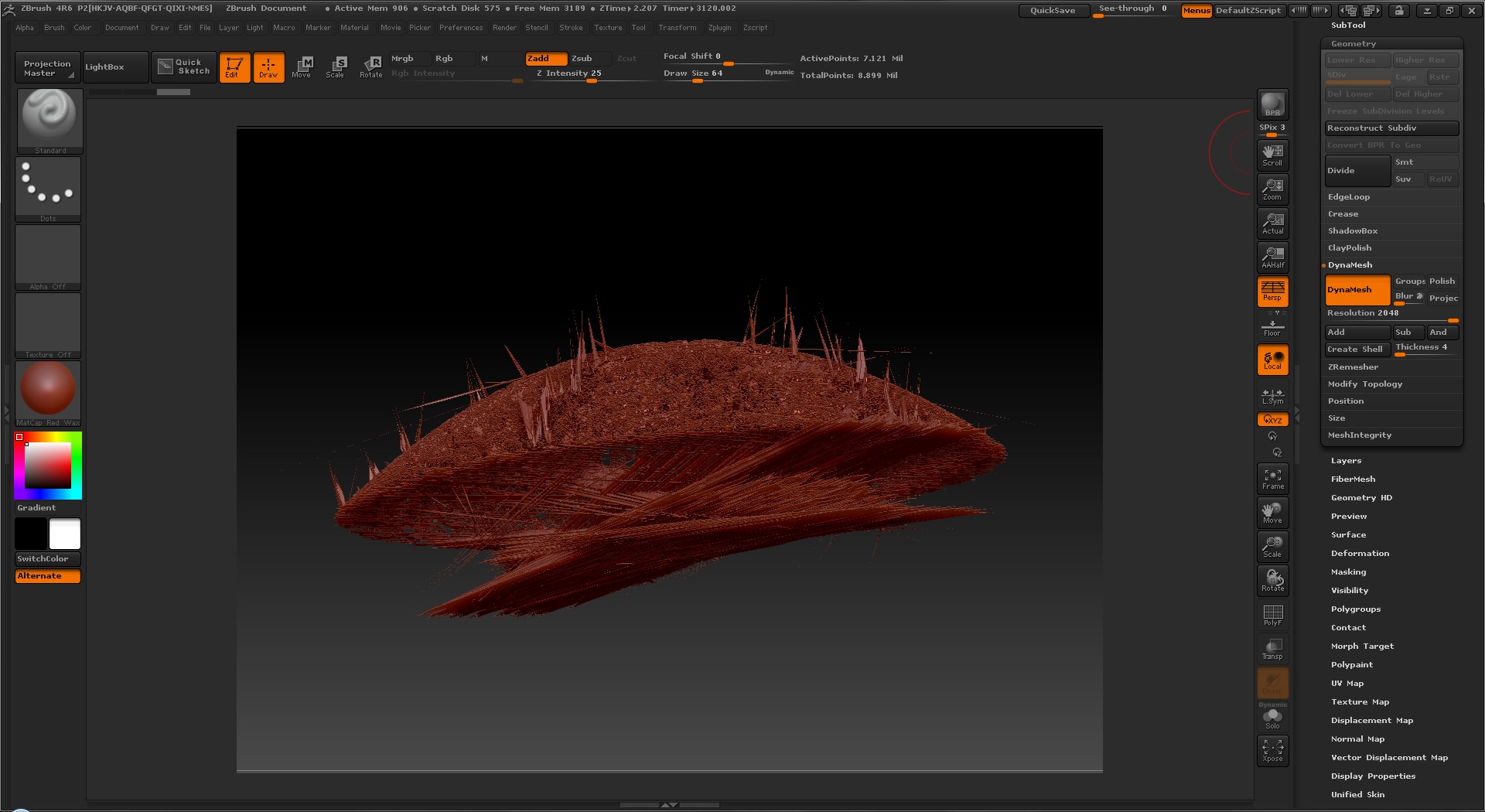

I tried this. The result is much worse. Attached is a pic with resolution set to 2048 and Project button off.

It almost looks like you have some holes in your mesh pre-dynamesh, or there is some stray masking going on.
Before dynameshing, clear mask, check/fix mesh integrity, and run close holes?
I’m not sure how to check/fix mesh integrity. I clicked on Close Holes before running Dynamesh and still got the same bad result. There are no masks as Zbrush wouldn’t let me run Dynamesh anyway if there were any masks.
http://docs.pixologic.com/reference-guide/tool/polymesh/geometry/#mesh-integrity
Thank you Thor and Doug. Checking/fixing the mesh integrity did the trick. I was able to dynamesh the original dragon top with no problems.
