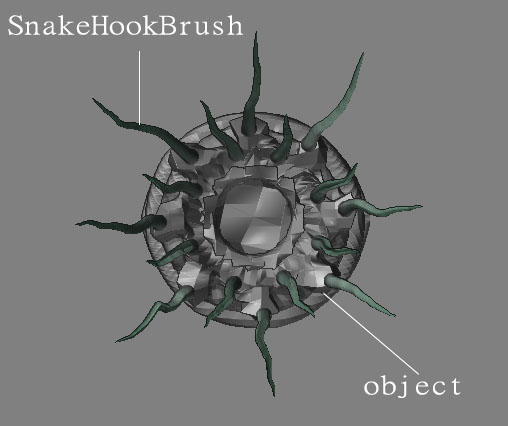

I would like to know why that after creating an object then I apply the SnakeHookBrush, I can’t save it as 3D object and rotate or scale as shown in the picture attached. After applying the SnakeHookBrush I wanted to rotate or edit the entire object. Isn’t this possible?
Is there any way to achieve that please?

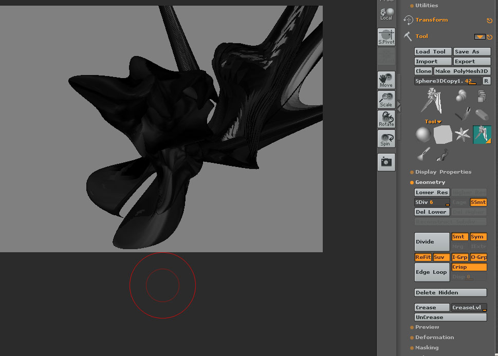

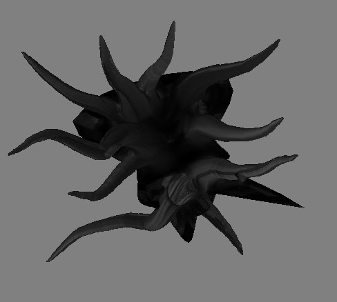

billrobertson42: I tried your technic in using projection master and I also checked the geometry, but no matter what my snakes always explode after when I pick up my object again… Sigh…
In the 1.jpg is when I’m in Projection Master using the snake hook brush, then I pick it up and it becomes like as shown in 2.jpg :confused: 1.jpg
