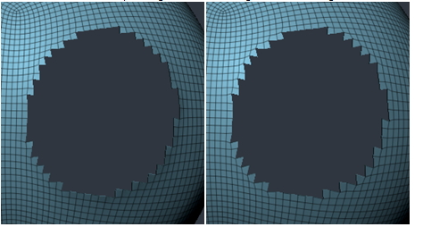

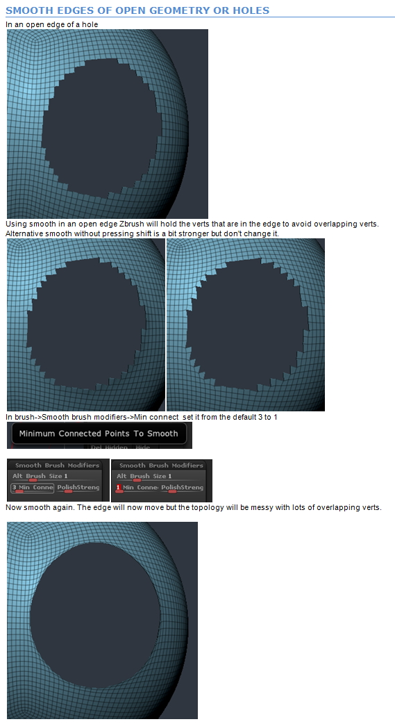

In an open edge of a hole
Using smooth in an open edge Zbrush will hold the verts that are in the edge to avoid overlapping verts.
Alternative smooth without pressing shift is a bit stronger but doesn’t change it.

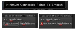

In brush->Smooth brush modifiers->Min connect set it from the default 3 to 1
Now smooth again. The edge will now move but the topology will be messy with lots of overlapping verts.
