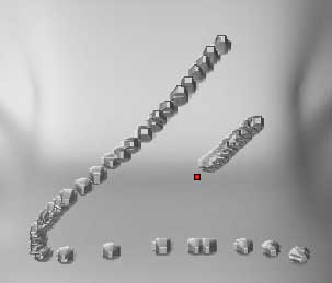

Hi, hoping someone can help me out here?
I’m importing my obj model (from Max) into ZB, and add 6-7 sub-divisions levels for fine details. When I adjust the brush size to say 1, and paint it seams that I’m using a much larger brush:- see below:
I have the Import/Eport Unify Scale setting in ZB set to 16 (makes it a little better).
Thanks for any help!
you need to scale up your model, under tool - deformation - scale
that will solve your problem.

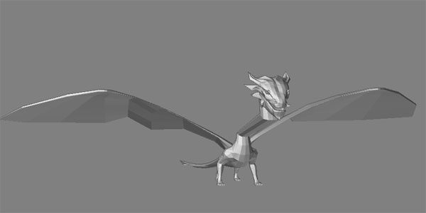

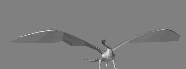

The same happens if you have parts of your mesh hidden. This really should not be a problem because the difference will be noticeable to you on the canvas when you unhide your mesh (scaling up a mesh by 100% will create obvious variants in size).
Hidden results:
It sounds like you saved your ZTL with hidden parts/masked parts. I have read here that you should always save your mesh with all parts unhidden/unmasked and at the lowest sub-d level to avoid any problems.
