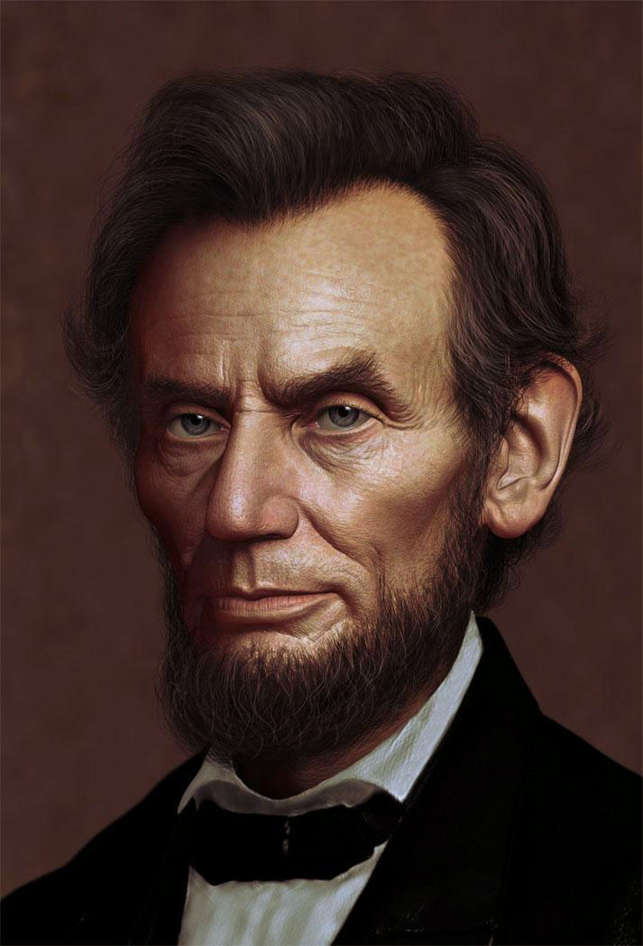

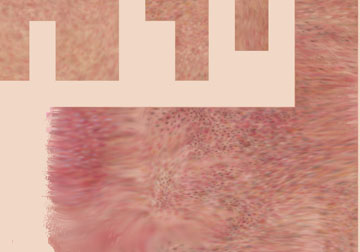

I finished this image , and decided to move on to new one.As I said in the last post . I was trying to find the best way to create human skin tone in Zbrush .I saw some examples in the forum and I could not find something I really like. I attached zip file and part of the texture so you can try what I did if you want to.I wanted material which won’t make so much difference after rendered. Because I had hard time to figure out what will happen after render when I was painting the color on the texture map. And lost patience by multiple crush. By this material setting and lighting setting , I wanted to do some sheen and red grow in the shadow area to imitate skin tone. Still need improvement . If someone has better idea , please share your way by posting your final image or just sphere and skin material and light setting. May be image of the model in fast shader too.Since thetexture will affect the color a lot . Or simply post the link to your post . We discussed about criticism on the last post , so no more about it on this post please .
I just want to talk about how you make skin tone. I also welcome something like Neville’s Alien.
Looking forward to seeing something cool . Any question welcome.

How was the hair done. Is it modeled and painted or just painted post production?
Portart,
Looks Great to me. I think the skin tone perfecto. Great job
and what about that hair. Is that ZBhair?

Dogbone, MrZankO ,Hair is done in Photoshop after I render everything.
Last night I was trying Deco Brush like Antropus showed in his great tutorial. I found it is good. I like it that the hair get tapered end.Brush in photoshop does same kind of effect too. Ron Harris, Thanks ,I hope you get better soon. I hope I can make somethig out of this portrait .Thanks S/_ayer, and Patton ,If you find a way to make it look like lightly tinted silicone look, please let us know . Aminuts , Thanks always , that is great help for everyone. Actually I missed a lot of posts before. I guess good thing won’t come that easy. Hoping in the future , there will be simple solution for great skin tone. I will go through those links. Thanks Frenchy and fizzy, I love the old man you made, looking forward to seeing next one . Thanks Meats Meier, I should have seen your DVD before I started this ,Great help. I hope I can work with this software like you do soon.

I’ve attached an image in which I’ve used Photoshop curves to bleed some of the red out of the midrange tones, and I’ve added some blue to the highlights.
This is just a cheap attempt to simulate translucency (slightly more red around the shadows) and the reflective qualities of skin (the specular reflections in skin shouldn’t have any tint, generally only metals have tinted reflections).
I think this shows off your work a bit more, shouldn’t be too hard to achieve the same kind of effect directly in ZBrush.gp2.jpg

Yes aminuts , I agree. That is why we all unique and different artist. Thank you very much PixelRod,wierdPal and Dremmer. Thank you Greg for spending your time to make it better . Actually the warmness of the color was bugging me for a while. There was an intension to make it warm and more red since I saw my posted image in different computer and they looked paler. So I tried to puch up the red, but it was too much. I think your version look great too, to me a bit too yellow and shiny. Now I cut down red a bit , so I think it look better .
