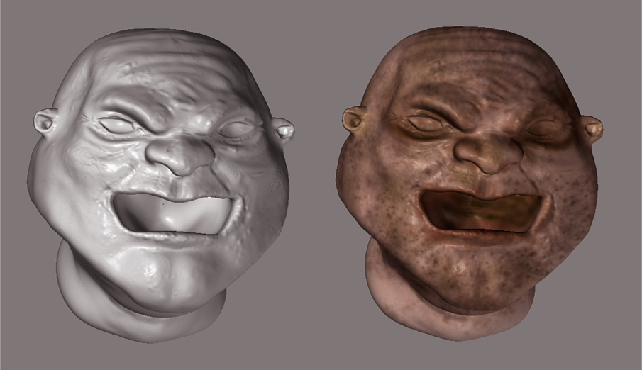

Hello. I have just started using zbrush, and I’m loving it more every second that pasess. I have some questions though. When I render, I press “best” and export it to a psd-file. I Open it in photoshop and it looks okay. The only problem is that the edges on my model is so sharp. I tried to mess around with the antialiasing-controller in Zbrush, but I didn’t get very far with that. Could someone help please. I would be very greatfull. Thanks. I have uploaded an example of my problem… It’s easier to see it on the clay-version…
That is an odd problem, most people complain about it not being sharp enough. Perhaps try the “Actual” button found under the zoom palate
Hmm… I tried to do that, but it didn’t help. I tried to press the button called AAhalf and that made the edges smoother. But then it also got so small. I have just no idea what I’m doing… Thanks anyway;)
-efish <><
Usually you double the size of the document and work in AAHalf or Fullsize and then AAHalf to output it!
Lemo
AA. I got it now. I had to press AAHalf and then Scale it back in. Thank you:D
