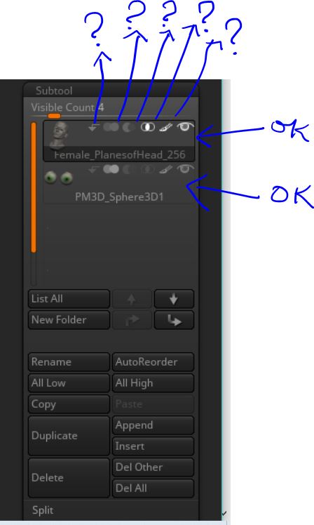

Hi and thanks.
My question was especific to these small things at subtool. Could you see the image I loaded? there are my questions.
Because I did assign the Material/ color too white for the face. Now I wish to assign the MATERIAL Plastic Toy for the subtool> Eyes. That is my problem: doing so all comes to be Material Plastic, and the frist material for the face vanishes…

The meaning of those symbols can be found in the online docs regarding subtools.
The answer I gave you the first time explains how to apply different materials to different subtools. I couldn’t have been any more clearer. It might be that you need to familiarize yourself with the Basic Concepts first to get a better understanding of the way ZBrush works. If none of those things work for you, then you may need to contact Pixologic Support.
