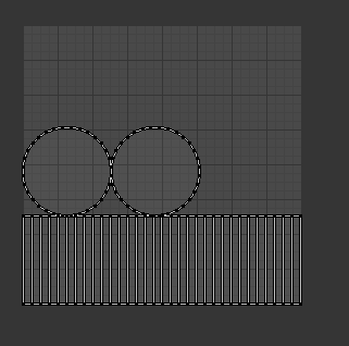

So, lets we used UV master to flatten a cylinder

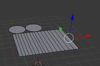

Is it possible to use this UV info, as an XYZ (just XY in this case) mesh? Is there a way for the software to do this?

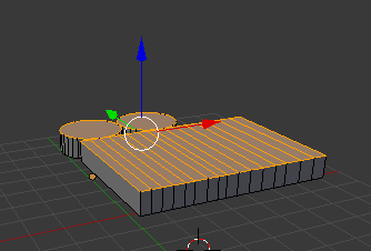

The application I have in mind is, to get a flattened UV mesh, then extrude thickness
then sculpt on this extruded mesh.
The purpose is to have scanned 3d data from a real life object (say of a comlpex curved surface) then flatten this curved surface, give it thickness, sculpt detail, 3D print this detail in flexible resin, then lay the print on top of the original scanned object.
Any advice would be appreciated.
The alternative solution in ZBrush, which I haven’t investigated, is after the getting the flattened UV, to use the flattened UV as an alpha mask to project the flattened shape onto a flat mesh.
