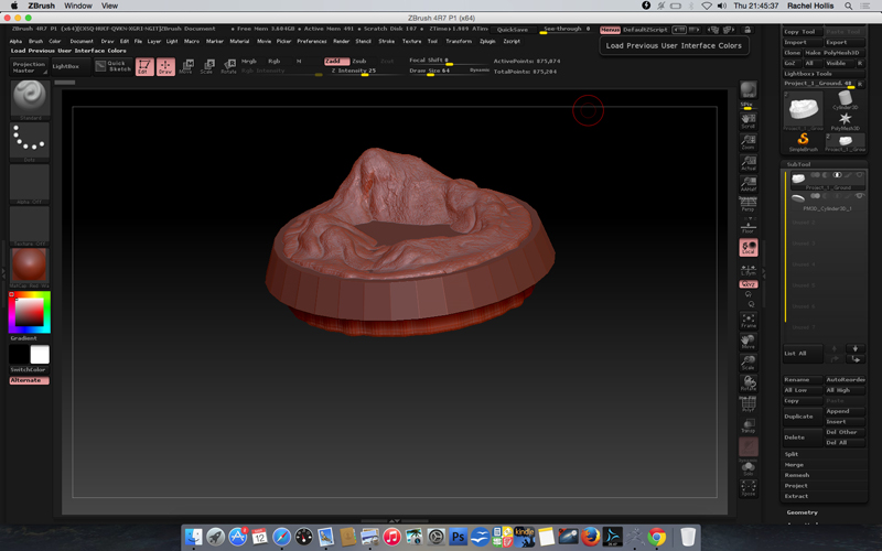

The issue is after creating a cylinder and subDiv that to 800K poly’s. I’ve sculpted the rocks and I’m supposed remove the bottom half for the ground to sit on a tempered cylinder. When I try to remove the bottom half it warns set to level1 subdue to delete vertices or delete lower levels and try again. Now, both of these work but only 1 is working correctly.

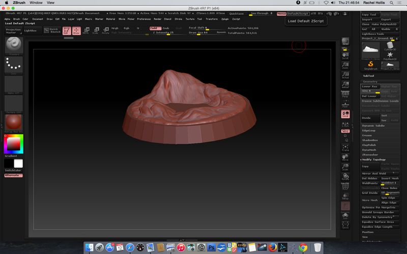

After setting level 1 and deleting the bottom of the cylinder when I return to level 4 I have also lost all the extreme detail in those rocks but have no idea why.

mask the tool at its highest level before doing the delete
I was not sure how to do that but finally.
Masking worked after a little thought and trials I managed it.
