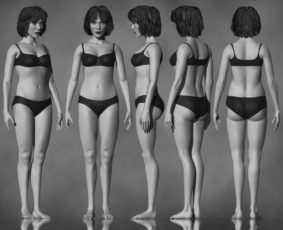

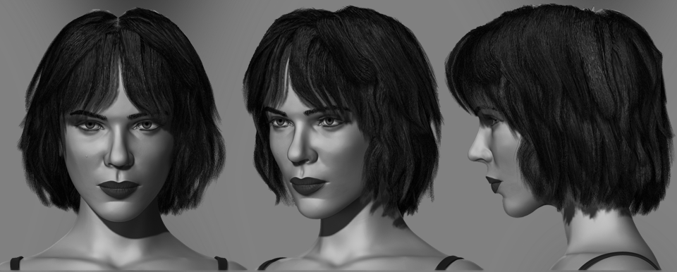

Hello everyone. I’ve been working on a sculpt of Scarlett Johansson (who hasn’t?) as a way to improve my female anatomy sculpt. This sculpt is based around the character Johansson played in the film Under the Skin. I just need your help to get some feedback to see areas that I can improve. Critiques are greatly appreciated. Thank you.

I’m not an expert working in anatomy, or in ZBrush either, but I’ll see what I can do to help…
For the most part her body looks pretty accurate, though not as detailed as the real body. The only things off that I can see standing out is that her butt is a bit too long [I’ve always had trouble with that myself, it always ends up bigger or longer than it should], her thighs are a little too short, and her arms are too small [their proportions are alright, they just need to enlarged and adjusted].
As for her face, it doesn’t quite look like her. I don’t know if it’s because of the lack of finer anatomical details or not, I definitely know that her chin and lower lip needs to be pulled back VERY slightly, it’s a very fine difference. I thought I saw a really detailed sculpt by someone around here, but I haven’t been able to find anything that isn’t at least equal to yours… so congratulations, you’re still probably one of the closest to recreating the real thing!
I think the thing you need to look up the most is the underlying anatomy of the human body, the muscles and bone beneath the skin.
